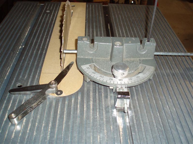

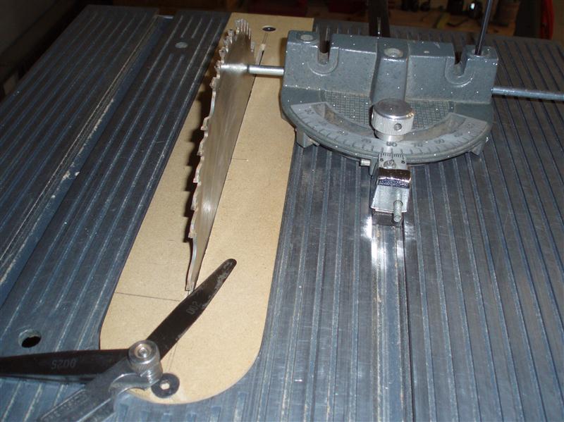

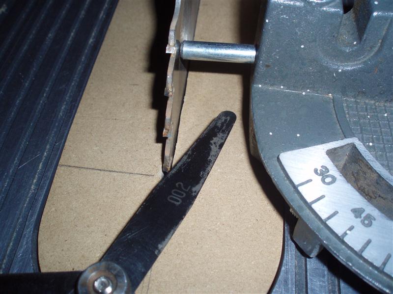

Giant Step Back to the Beginning
This is NOT a step backwards just a step back to the beginning.
I have been fussing with other ways to align my Mark V tables to the blade and have come up with a couple different methods that work quite well.
Keep in mind that I do this procedure with the self imposed criteria that the blade must be parallel to the miter slot to within .005". I don't think that this number is used anywhere by Shopsmith but it works well for me.
My most recent method is discussed earlier in this thread and I might add that I have now used this method on both of my Mark Vs with near equal degrees of success.
Others have indicated a preference for other methods, like the dial indicator and I agree. But I decided to take this exercise one Giant Step Back to the Beginning.
When I first got my Mark V I was taught how to do this alignment using the Miter Gauge and a long rod. Most all of you have probably seen this done or even do it now yourselves. I am here now to tell you that that method is every bit as good as using the dial gauge.
I decided today to "check my work". I did this using feeler gauges, the rod and the miter gauge. I'll not discontinue using the dial indicator but it certainly is not a requirement.
[ATTACH]19316[/ATTACH]
[ATTACH]19317[/ATTACH]
[ATTACH]19318[/ATTACH]
I cannot insert the feeler gauge on one side and can feel the feeler gauge drag as I pull it through on the other side. I would say that I am within .003".

- The Old Way 004 (Custom).JPG (75.74 KiB) Viewed 1396 times
- The Old Way 005 (Custom).JPG (84.96 KiB) Viewed 1395 times
- The Old Way 006 (Custom).JPG (78.65 KiB) Viewed 1395 times
