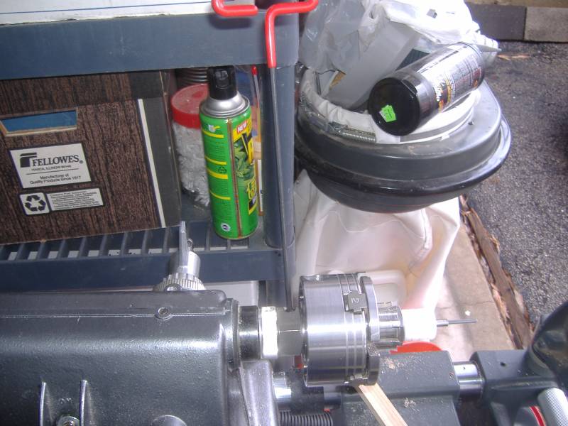

I must have one of the few Nova chucks that have 1"x8 threads. Maybe the Nova midi chucks are that way. I only use the one adapter.

By the way, the midi by Nova is a nice chuck. Here's a pic of the setup on one of my 10er's.
[ATTACH]19911[/ATTACH]

Trainguytom, can you show us a photo of you chuck mounted on your 10er that shows the back of the chuck along with the Penn State adapter.

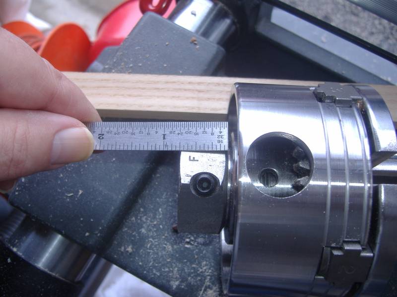

Hi,
What seems to be missing is the adapter I got when I ordered my chuck from shopsmith.
Since we are rehashing this yet again. I have an adapter that has a "F" stamped on it. The set screw is the stock shopsmith size. It is angled just like it should be. It works fine and I have no interest in replacing it.
It does not look like either of the pictured ones so I'll and a pair of pictures.
In the first picture you can see the allen wrench fitting the setscrew and the taper matches the angle of set screw hole.
[ATTACH]19921[/ATTACH]
The second picture show how wide the "nut" is, and that the setscrew is not on the flat, it also shows the "F" stamp.
[ATTACH]19922[/ATTACH]
