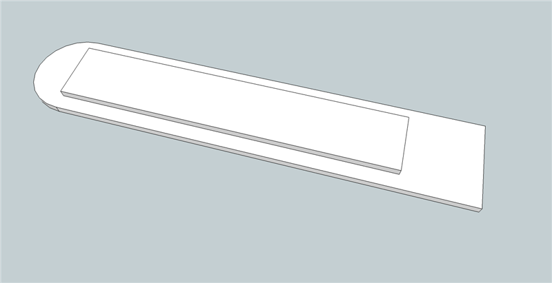

Sometimes it is not quit that simple. In the case of my ZCI it becomes a matter of how accurately I do the setups. I do some routing/rabbeting when I make ZCI.
This image depicts the underside of a ZCI that is made from 1/2" stock. How well it fits is dependent upon how much was routed off the bottom side. The thinner areas are the result of that routing and should be a tad more that 1/4" thick (about .257").
[ATTACH]19960[/ATTACH]
[ATTACH]19961[/ATTACH]

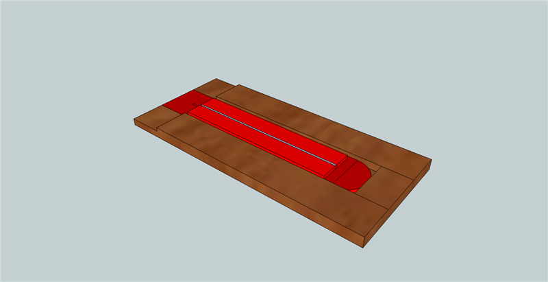

This is used to feed the ZCI through the router with one end against the fence. The fence is adjusted according to how deep into the end you want to cut. Four passes with a 3/4" router bit gets me to the 2 1/4" with some overlap. Flip the ZCI end for end and cut the other end.
- ZCI Pattern Dimensions (Custom).png (41.52 KiB) Viewed 3413 times
- ZCI, Cutting Jig (Custom).png (86.26 KiB) Viewed 3387 times
