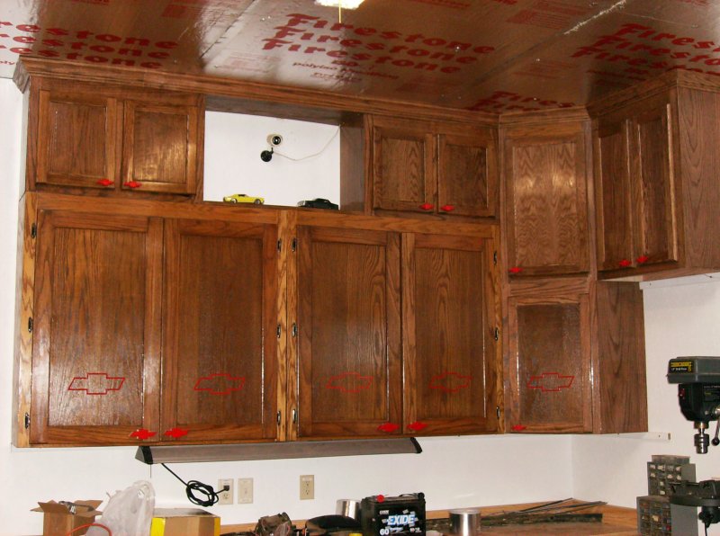

I built my garage cabinets out of Oak veneer plywood (wood core) scraps left over from my other projects. If you do a lot of woodworking, you always have a huge pile of left over wood. When you reach the point where you can no longer deal with the pile, build yourself cabinets like this for the garage or shop. This is scrap cabinet grade plywood and solid oak.
- cabinetdone.jpg (128.36 KiB) Viewed 2726 times

Right nice cabinets. If I built cabinets that nice in my shop I shutter to think what the Mrs would demand for in the kitchen.garys wrote:I built my garage cabinets out of Oak veneer plywood (wood core) scraps left over from my other projects. If you do a lot of woodworking, you always have a huge pile of left over wood. When you reach the point where you can no longer deal with the pile, build yourself cabinets like this for the garage or shop. This is scrap cabinet grade plywood and solid oak.
