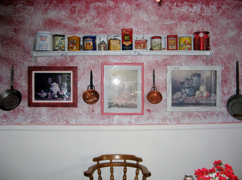

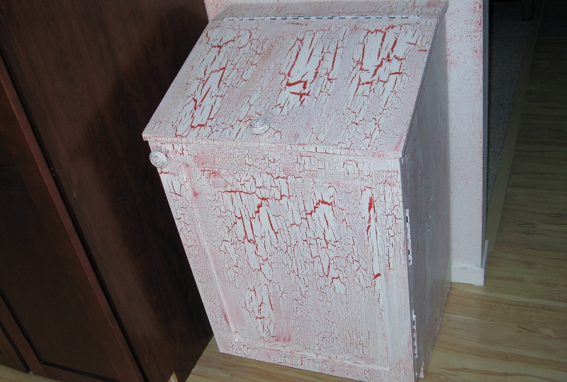

This a garbage container that is used many times a day.
[ATTACH]19965[/ATTACH]
The shelf & flat picture frames are MDF. I used the SS miter cutting fixture on the picture frame joints (0 gap at corners my SS miter fixture is dead on) and glue only no fasteners
[ATTACH]19966[/ATTACH]
The hutch is 100 percent MDF no wood.
[ATTACH]19967[/ATTACH]

stumpbuster: I love your furniture and decorating scheme. Does any of that antiqued paint tend to chip off.

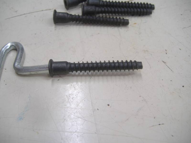

Hi,
Thought I might do a little show and tell. I use MDF for a lot of jigs and other simple projects. I don't like it for larger projects as the weight is not one of the things I normally look for in a material. Off hand smaller speaker cabinets are an exception.
A lot of things around the shop lend themselves MDF and the fact is very dimensionally stable.
If you fancy bisque fastening this stuff works quite well with them. Holding screws is not too bad but if higher stresses are involved they can pull out. Glue works well, ends will take up more glue then the flat sides so I often glue twice. (quick coat then a second reapply on ends/edges)
I have no problem cutting it but as mentioned it can create a lot of "dust" so setting up to collect that dust is a good idea. Remember the dust you don't see is the one you want to catch more of. Heavier chips can be done later by hand vacuum or dust brush.
I use for the most part carbide edges and I don't believe the wear is much of a factor. I also believe that drill bits and those sorts of tools are like wise not effected all that much. You would have to do a lot of projects before you have to even start worrying.
Now I can't remember what these screws are call or where I got them but since they work in particle board they will most likely work well in MDF. Here is a picture of the screw, you need to get the matching drill bit which I wasn't able to locate tonight so it is not pictured. Perhaps someone else can remember the name? (Drill bit is expensive).

Confirmat Screws - good for MDF and particle board.reible wrote: Now I can't remember what these screws are call or where I got them but since they work in particle board they will most likely work well in MDF. Here is a picture of the screw, you need to get the matching drill bit which I wasn't able to locate tonight so it is not pictured. Perhaps someone else can remember the name? (Drill bit is expensive).
[ATTACH]19968[/ATTACH]
http://www.rockler.com/product.cfm?page=652
