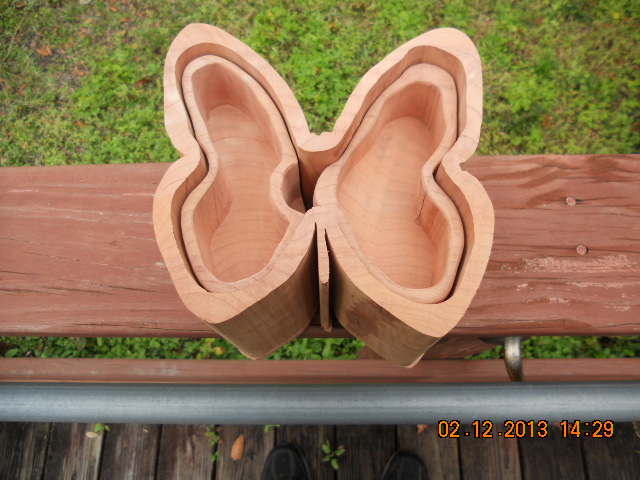

This is the second tray. Debating with myself whether to leave the bottom where it is to conceal what is in the bottom or conform it to the rest of the tray. Also, shown here are the small support that will hold the tray off the bottom without taking up much space in the bottom of the box.
[attach]20226[/attach]
Here is almost what it will look like once glued and inserted. The little pill bottle contains sanding dust. This dust will be used to make a mixture with glue to conceal defects.

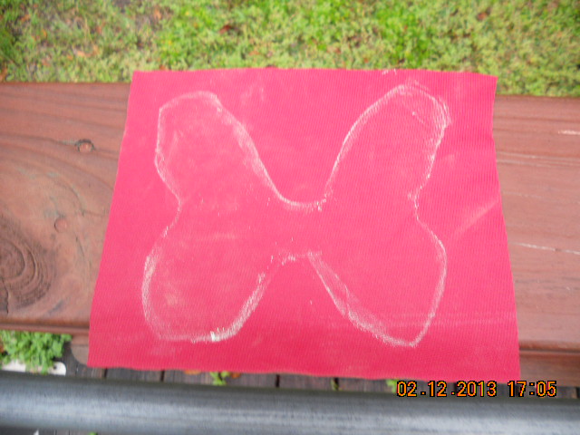

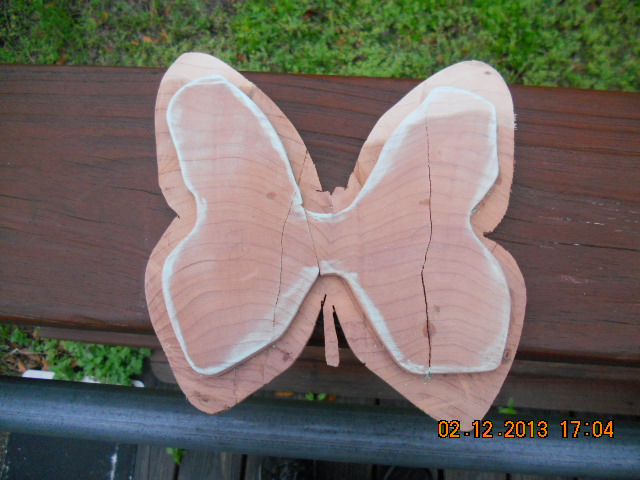

Since the top and bottom panels continue to split, will cut off 1/4" sheets of the parts removed from inside the box and glue to the bottom for reinforcement. After putting that in place, it is still splitting. May have to resort to something else. Before gluing, had to put the modified bottom under box to trace for trim for tray supports. Got them shaped and glued and now chalk to make an image transfer to fabric.
[ATTACH]20255[/ATTACH]
Image transferred and this will guide the cut on the larger side. Afterward, will start with a couple spots of hot glue on one of the wing tips while holding back the fabric. Will glue sufficiently to hold it in place. It will fit inside of box and after lining the sides, will look very much like one piece of fabric. It's going to be a couple of days before I return. I've decided to discard the top and bottom panels. They continue splitting. I've never had a glue joint to pop loose before. So, will reach into my stash and resaw new panels and hope to get the grain to come close.

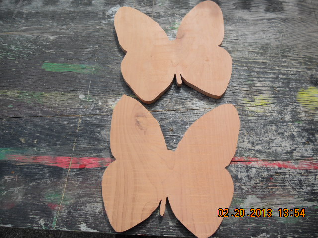

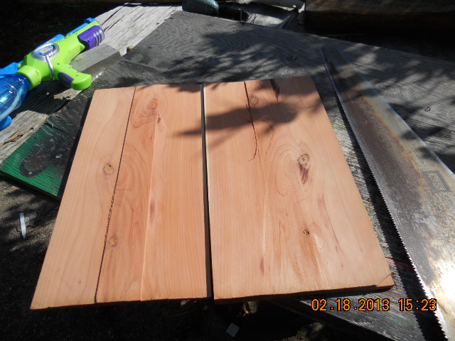

As you saw in the last post, the bottom kept cracking on me. I suppose I didn't put enough pressure on the clamping. So, got an 8 inch board from the same tree, cut it on both sides with the tablesaw. Then finished the cut with a hand saw.
[ATTACH]20303[/ATTACH]
Used board on right and sanded it smooth and to about 3/8" thickness. I find that the 1/8" blade I used to cut out the pattern flexes cutting through all that wood. So, turned the box upside down and traced the outline onto the board. Then turned the box right side up and traced the bottom of the pattern. Marked the top pattern with "T" and the bottom with "B".
[ATTACH]20304[/ATTACH]
Results of bandsaw cutting. Grain and color won't match but this is a CYA position at this point.

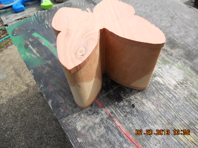

Have the bottom glued on and sanded. If I could have used the original pieces, it would have looked very much like it all went together. This will do for an 8 year old, I hope. Anyway, here's more pics.
[ATTACH]20563[/ATTACH]

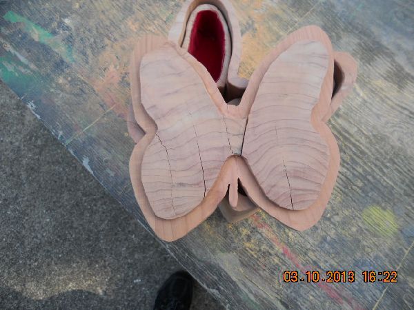

I continued with the usage of the insides I had cut to reinforce and stabilize the lid. I must be very heavy handed in clamping as this inside part just simply disintregrated as the clamps tightened on the glue. This keeps the lid in place. You can see a small crack that developed in the new piece as I was clamping these together.
[ATTACH]20564[/ATTACH]
This is pretty much how it fits after shape sanding. Except for the wood grain, it appears to be much like one unit.
