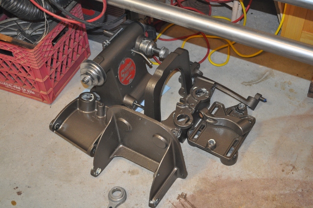

Restorations just about complete. Time to get busy with turning bowls.
[ATTACH]20259[/ATTACH]

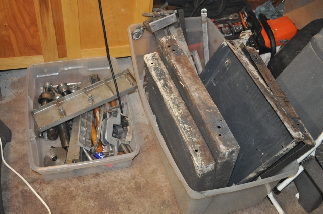

# 2 10ER finished with restore and waiting for a stand to be mounted on. Will be used as a dedicated Jigsaw Station
[ATTACH]20260[/ATTACH]

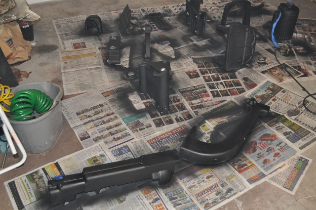

# 3 just received a primer coat of paint. Will apply final coat tomorrow evening. Jigsaw and motor also getting fresh paint. This unit will probably be used for pen and small bowl turning. I will continue to use the 520 PowerPro for large bowls.
[ATTACH]20261[/ATTACH]
Remaining parts waiting for evapo-rust to clean up legs for bases. Will polish up all remaining parts with wire brush mounted in # 1 10ER.

Cover the way tubes.fredsheldon wrote:[ATTACH]20259[/ATTACH]
. . . Will polish up all remaining parts with wire brush mounted in # 1 10ER.
