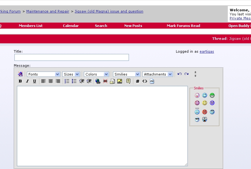

Different screen. No paperclip
Dusty:
thanks for the help and the snapshop. I now see in your screenshot the paperclip but you will see that mine does not have it.
I'll have to review the settings or could it be the browser?
See attached screenshot.

\I don't know how to help. I have seen that screen shot before but I don't recall where.eartigas wrote:Dusty:
Which Browser are you using?
Eartigas, "Attachments" on your menu bar is the same as the "Paperclip" icon on the one Dusty posted, yours is just set to display text instead of icons, every thing else should work the same.

rpd wrote:Eartigas, "Attachments" on your menu bar is the same as the "Paperclip" icon on the one Dusty posted, yours is just set to display text instead of icons, every thing else should work the same.
I shall try! Stay tuned. Test follows:
[ATTACH]20356[/ATTACH] to click there.
Eureka. Attachments is a drop down menu for me and after I upload it appears there as an option in the dropdown. THANKS!

Chrome does not show the paperclipeartigas wrote:Dusty:
IE does
FireFox does

The Paperclip is an icon for - guess what: Attachments. I guess I MIGHT have known that but it did not register with me at all when I saw your screenshot.eartigas wrote:I shall try! Stay tuned. Test follows:
I am glad to hear that you now have this capability available to use.
Paperclip mistery
Thanks to all that assisted me. This is one of the many examples of forum collaboration I have received and headaches computers have given me.
As somebody pointed out I am using Chrome as the browser and it presents things differently.
Now I can go wild with this!
