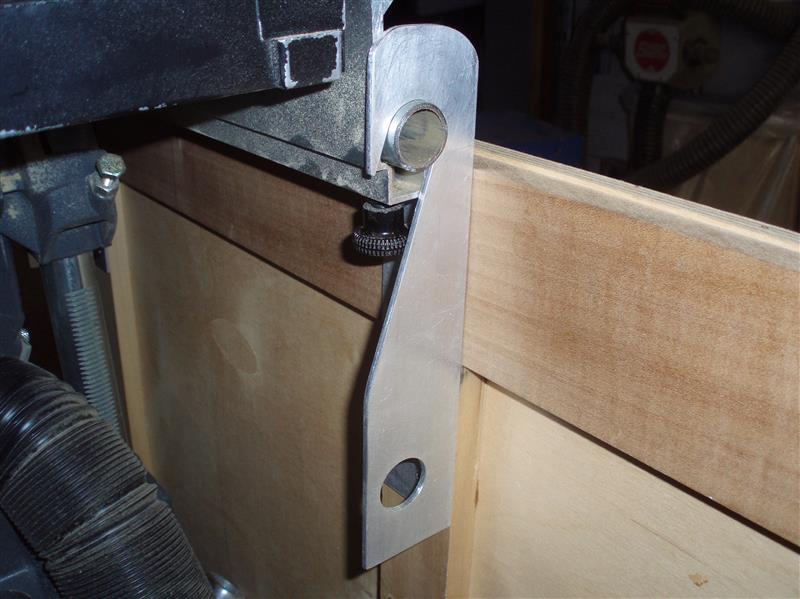

I built my brackets from a piece of 2" aluminum angle.
[ATTACH]20571[/ATTACH]
The extra hole in mine allows them to be used in conjunction with the Shopsmith Extension Table Brackets. When I do that, there is no need for the angled support bar or a table leg. Messing with a table leg every time I changed table position is what made it necessary to develop my outfeed table setup. No fuss, no muss. Just adjust table height or tilt and the outfeed table goes along for the ride.

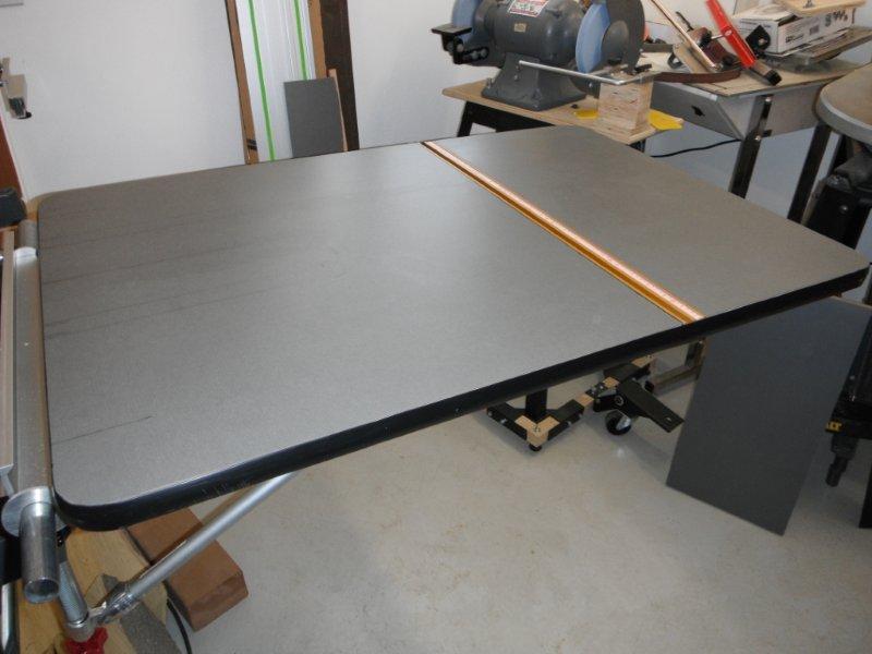

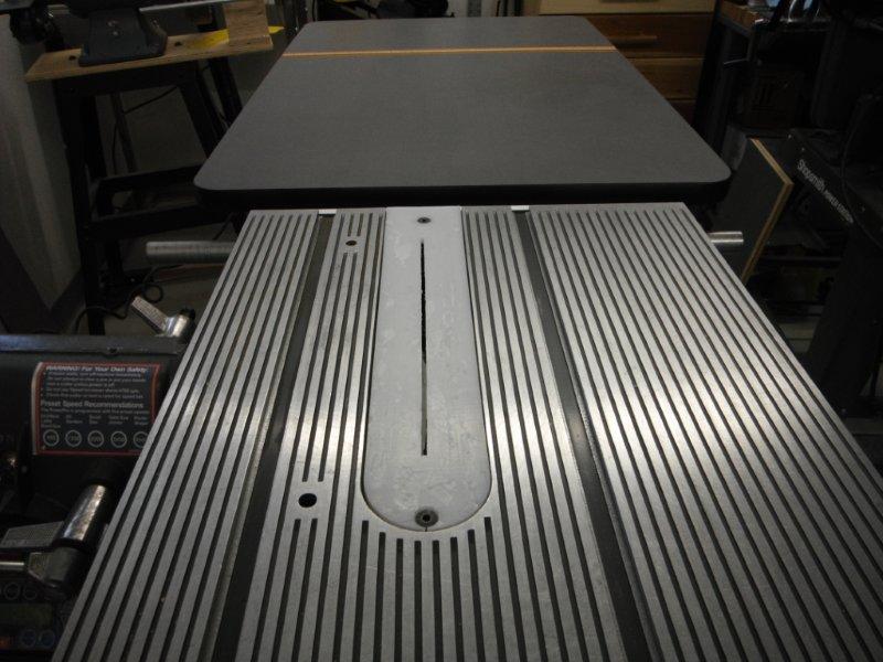

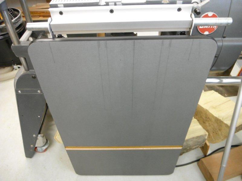

After reading all of your information on outfeed tables, I decided to build an outfeed table for myself. I installed a Formica top (color: Steel Mesh) and a 1" strip of plastic T-moulding around the perimeter. Its made of two 1/2" thick laminations, the top MDF, the bottom plywood. I used a Incra track (Shopsmith track was way too expensive compaired). I'll make a wood fence extension jig to replace the SS miter when cutting bevel cuts. I still have to cut the miter slots and a slot for the extended riving knife. I also made the wedge device to support the OFT with the SS table tube.I still have a little painting and cleaning to complete it, but I'm close. I just have to figure out how to make the lower SS support rod to table connection better so it will swivel when the table is adjusted to 45 degrees.:)

wasatch wrote:After reading all of your information on outfeed tables, I decided to build an outfeed table for myself. I installed a Formica top (color: Steel Mesh) and a 1" strip of plastic T-moulding around the perimeter. Its made of two 1/2" thick laminations, the top MDF, the bottom plywood. I used a Incra track (Shopsmith track was way too expensive compaired). I'll make a wood fence extension jig to replace the SS miter when cutting bevel cuts. I still have to cut the miter slots and a slot for the extended riving knife. I also made the wedge device to support the OFT with the SS table tube.I still have a little painting and cleaning to complete it, but I'm close. I just have to figure out how to make the lower SS support rod to table connection better so it will swivel when the table is adjusted to 45 degrees.:)
Add a 5/8" offset.;)
Very well executed. Much more "professional than mine. I know you will get great service from this OFT. I believe that some device like this is essential for safety reasons if not just convenience. Being able to adjust depth of cut with a lot of fuss is all the payback I need.
The tilt feature does create some issues. My support rod is still undergoing change.

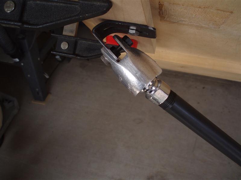

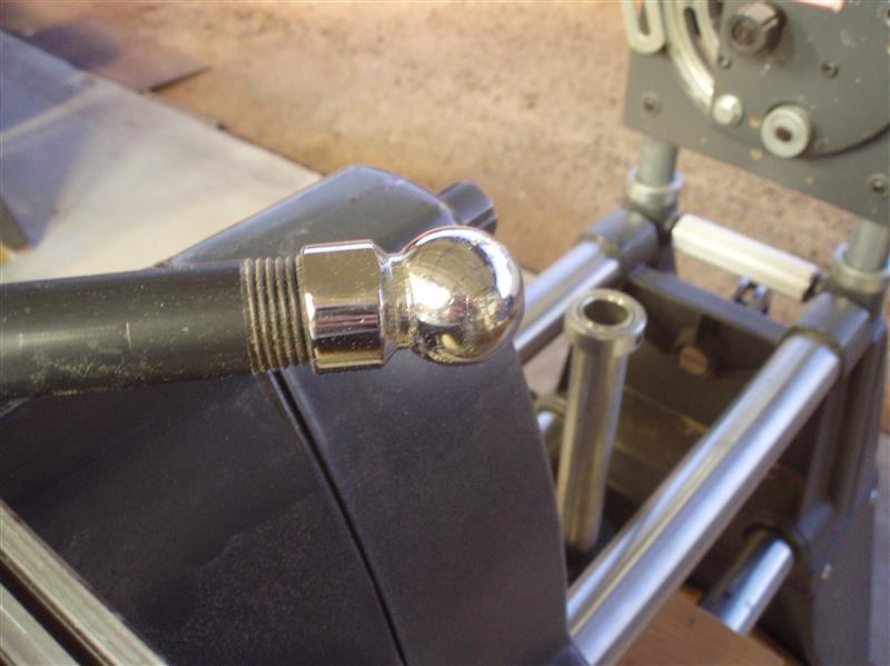

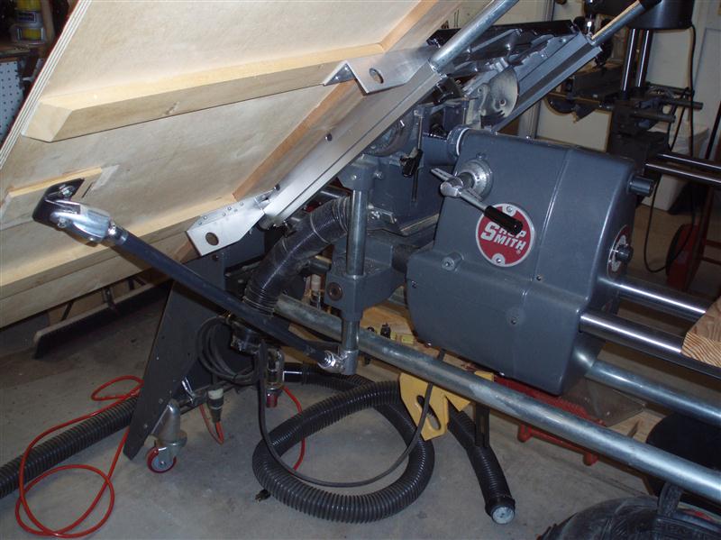

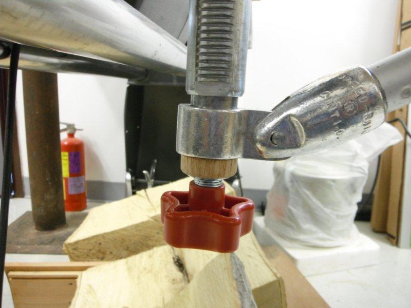

Here is what I am using now.
[ATTACH]20666[/ATTACH]
[ATTACH]20667[/ATTACH]
[ATTACH]20669[/ATTACH]
This set up eliminated the binding that I experienced when I tilted the table. The table still droops about 1/2" when tilted.
The bracket on the under side of the OFT can be repositioned to achieve a level plane with the main table.
I am curious about the brackets that you use to attach the OFT to the main table. Would you consider a couple photos.
Please ignore the clamps that visible in these photos. Those clamps have been replaced with glue and screws.
Outfeed Table 2013 008 (Custom).JPG (79.33 KiB) Viewed 2915 times
New Support Rod 001 (Custom).JPG (42.7 KiB) Viewed 2905 times
Outfeed Table Brackets 007 (Custom).JPG (54.15 KiB) Viewed 2901 times
