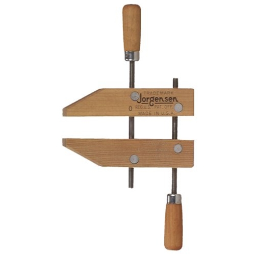

Best tool I have used for clamping small objects for machining is a wooden clamp.
I have a few of these in different sizes, not the manufacturer shown, but you get the idea.
[ATTACH]20581[/ATTACH]
- woodclamp.jpg (39.51 KiB) Viewed 2125 times

Your using this horizontally on the table, I guess ...terrydowning wrote:Best tool I have used for clamping small objects for machining is a wooden clamp.
That could be a solution.

Yup laid flat on the table. Provides a nice flat stable but movable platform for small items. Some pen makers modify these for blank drilling by cutting square notches in both sides to hold round and rectangular stock.
I have not modified any of mine yet as I drill my pen blanks in lathe mode.
