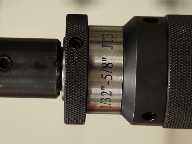

I just received mine today, but I must have ordered the light weight version, since it only weighs in at 3 lbs, 2 oz, with the arbor. The chuck is labeled JT3, which I had to google to find is a Jacobs Taper 3, and although there is a threaded hole in the end of the arbor, the chuck only mounts with friction. I haven't had a chance to mount it on the SS, but I chucked up a 5/8ths bowl gouge (measured a true .625 on a digital caliper) and it fits fine. However, if you open the jaws a little farther, the chuck is forced off the arbor taper, so remember to hold on tight when opening the chuck to the maximum.

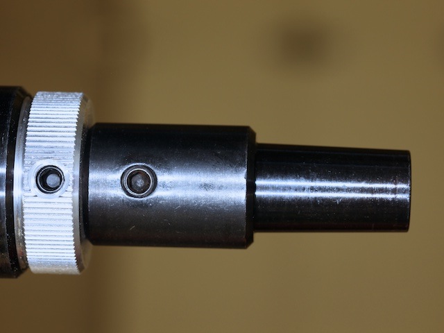

Tapered arbor. I have things to learn here, because when I tried drilling a 1/2" hole in a 2 by 4, the chuck and bit fell off the arbor when I was clearing chips.

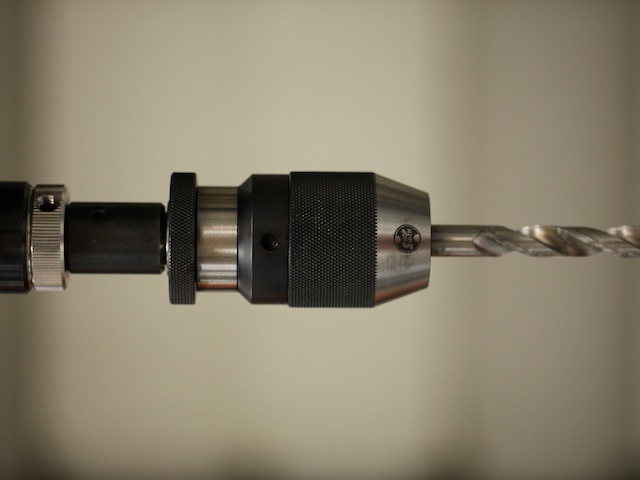

Chuck with 1/2" bit.

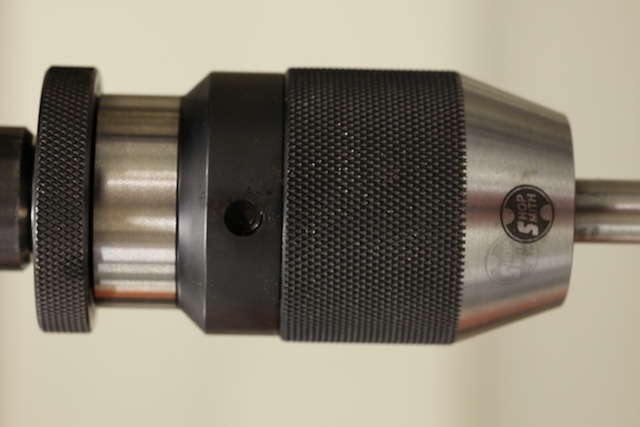

Closer view. If this was a double struck coin, I might be rich.

Collar Labels

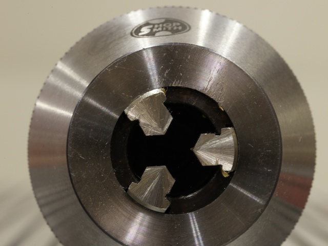

Business end.

Good pics, thanks. What did you do to re-install the chuck on the arbor? Do you have to hammer it on or is there a threaded hole in the chuck end of the arbor?

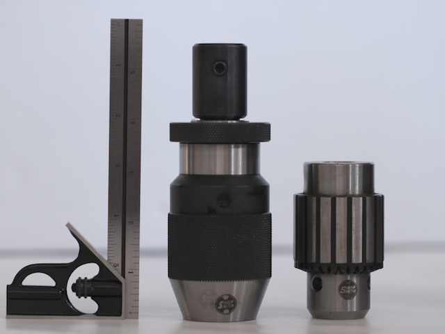

I have moved most of my drilling to a 'shorty' and I believe that this keyless chuck is enough longer than the regular chuck that it might prevent my chucking normal bits.
This is something for everyone to think about when deciding to go for a shorty.

I cleaned the residual packing lubricant from the tapered arbor and the chuck bore and drilled holes up to 1 inch diameter. The chuck stayed on the arbor just fine. Its is also very easy to open to change bits. Time will tell if it grips as well as a keyed chuck. I wasn't able to test for runout, but the test holes all seemed smooth, round, and straight.
Here is a comparison shot confirming what Dusty said. You lose 2.4 inches of drilling room.
[ATTACH]20995[/ATTACH]
I finally found my original chuck so that I could take this picture, now if I could only find the key.
