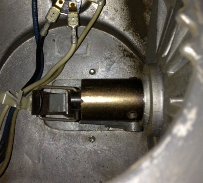

I was hoping someone would mention that. I just picked up a project machine for very little that hums and had lost the clip on the button bearing. As soon as I freed the belt the motor turned with no issues. I was wondering if the clip lets go the belt can drop too low and lock up in the sheaves.JPG40504 wrote: Step one: PIX!!!! - belt in idler pulley - quadrant gear against control sheave button*.
* This may be the 'kicker'! IF the button/bearing are 'missing', the control sheave can open too far allowing the belt to drop down too far. Then there may be 'issues' with the quadrant gear(etc.) itself.
The clip is there for one reason only - to prevent the button from rotating thus allowing the button to slide on the quadrant with minimum wear. Since the control sheave rotates, a bearing is needed.

JPG40504 wrote:* This may be the 'kicker'! IF the button/bearing are 'missing', the control sheave can open too far allowing the belt to drop down too far. Then there may be 'issues' with the quadrant gear(etc.) itself.
Here is a picture if the way the clip should look
[ATTACH]20958[/ATTACH]
- image.jpg (54.3 KiB) Viewed 1888 times
I studied the picture you sent and it looks pretty much like mine except a tad bit cleaner. One thing which may make a difference on mine: The worm gear seems to have traveled past the gear teeth on the lamb chop(?) I don't know if this is leaving the machine stuck in the full high speed or low speed mode. When I try to turn it by rotating the sanding disc the inner shaft turns inside of the outer shaft which would rotate the gilmer drive if it turned. While doing this I rotated the speed control. I know your not supposed to do this but I wanted to see what happened inside when you did and nothing inside the machine moved.

I think we found the problem. Unhook the clip and turn the speed control to slow. After it is set to slow, turn the speed dial toward fast WHILE putting pressure on the top of the porkchop and push toward the base of the worm gear. As you turn the speed control toward fast, it should thread in. After it is threaded in and the dial is set to fast, reinstall the clip and belt, and do a high speed adjustment.brin wrote:The worm gear seems to have traveled past the gear teeth on the lamb chop
