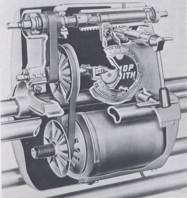

Edit: This picture may help also, it helped me "see" how everything fits together
[ATTACH]20914[/ATTACH]
- image.jpg (55.9 KiB) Viewed 2203 times
There are three major pieces to the headstock.
The steel belt cover on the left end of the headstock. It is merely that, a cover.
The motor pan is attached below the headstock casting and contains the motor and power cord strain relief.
The third and major part is the casting which contains all the drive and speed control stuff and unfortunately also the power switch.
'Normal' disassembly starts with the belt cover. It is secured with two(8 on older models) screws. If the two shafts have hubs attached, they must also be removed to get the belt cover off.
The motor pan(and motor) is removed by first setting the speed control to fast(manually rotating the quill shaft if necessary). This allows easier removal of the belt from the motor pulley. Last, the wires must be removed from the power switch.
FWIW, removal of the speed control also requires setting the speed control to 'fast'.
If you have not already done so, do remove the belt cover. It will make many things more accessible.
When the belt is NOT on the motor pulley, the speed control may be adjusted with no concern if the shafts are turning. Just make sure the belt does not get caught between the idler shaft sheaves.
I would oil the control sheave with it set to fast. Oiling the floating sheave on the motor shaft is easier with the belt off.
If you do pull the floating sheave out manually, do make sure you release it slowly so it does not slam it into the fan sheave.
A lot to absorb at one sitting, but it should prevent making things worse.
If your belt cover only has two screws, the sheaves should have oil holes. Do not be stingy with the oil. It probably has not seen much in the past. SS says a few drops, Our resident guru Bill Mayo says at least 10 drops. Lack of oiling is the single most detrimental thing you can do, and unfortunately most do not get that oil every 10 running hours. Those that do, seem to run forever(half a century at least). Any excess oil will be thrown out into the interior of the casting. A good step is to raise it to vertical after oiling so that the bearing in the end of the idler sheave hub will get oiled. It is a high failure rate item due to lack of lubrication.
As for the high speed adjustment, that can be done 'last' after it is reassembled.
And last, do check the belt width. A 'new' one will be wider than 1/2" across the outer surface. One less that 7/16" should be replaced(narrow belts have a propensity for getting stuck between the sheaves!!!!!;)).
Last + 1, With the smaller 3/4 hp motor, it is recommended that the speed be returned to slow before powering down. This greatly reduces the time the motor takes getting up to operating speed. Experience will indicate the relative importance of that to your situation(power source etc.). It is a good policy to return the speed control to slow when either shutting it down at the end of a 'session', or prior to moving it.
Whew!!
