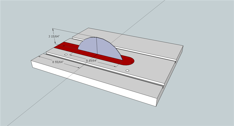

EXCEPT: One small issue that could be eliminated at this point. Where is the center of the main shaft (front to back) with respect to the main table? The back edge of the table is 8 55/64" back from the center of the drive shaft (the blade arbor).
