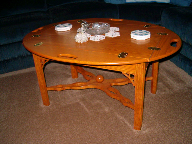

swampgator wrote:You never want to mix oil based with water applications in the same job. Water based stains/dyes for water based finishes. Oil based stains/dyes for oil based finishes...
Have to post a disagreement with that statement. Oil based stain after cured can successfully be finished with water based polyurethane. I've done this on every piece of furniture I've made. From tables to corner cabinet, chests, TV consoles, etc. Of course you must wait until the oil based stain is fully cured before applying the poly. My favorites are Danish oil stain and Varithane brand urethane water based floor finish.
[ATTACH]21360[/ATTACH]

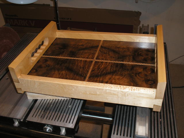

Nice piece, Chuck!
This piece of mine also has water-based poly over oil first-coats... still doing well after 4 years.
[ATTACH]21361[/ATTACH]
Tea Serving Tray.jpg (47.32 KiB) Viewed 1218 times
