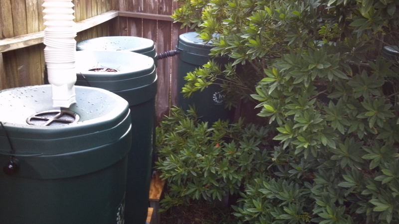

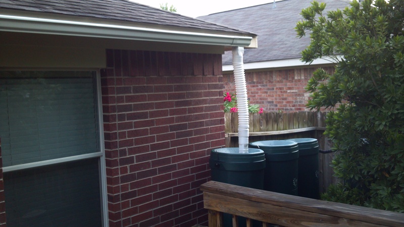

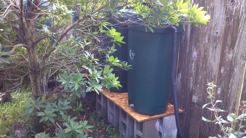

Installed last 3 rain barrels yesterday and it rained 1/2 inch today which filled 2 of the 3 additional barrels. So it looks like I will be able to collect 240 gallons of rain water for every inch of rain
