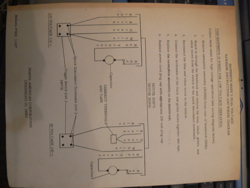

From what I have been told, by my wife's brother, this 10ER was definitely powered by 220v. The motor plate does say 220 / 110 as its power sources. However there is no indication of wiring differences for each source. I am an electronics technician and have done a lot of wiring over the years on radiology equipment. It has been my experience that those two voltages, as inputs, are wired differently. Typically, one has two hots and a ground, the other has one hot, a ground, and a neutral. Since neutral and ground are essentially the same (for the 120v circuit), at the breaker box, where they go at the device being powered is important. I certainly do not want to burn up the motor but I also do not want to create a hazard.

You ARE correct re 'typical' 230v 'appliance'. Particularly so if it of the 'portable' variety and HAS a 'linecord' with a plug attached(3 or 4 wire depending on application).mada1 wrote:From what I have been told, by my wife's brother, this 10ER was definitely powered by 220v. The motor plate does say 220 / 110 as its power sources. However there is no indication of wiring differences for each source. I am an electronics technician and have done a lot of wiring over the years on radiology equipment. It has been my experience that those two voltages, as inputs, are wired differently. Typically, one has two hots and a ground, the other has one hot, a ground, and a neutral. Since neutral and ground are essentially the same (for the 120v circuit), at the breaker box, where they go at the device being powered is important. I certainly do not want to burn up the motor but I also do not want to create a hazard.

However, motors of this size which ARE 230v or dual voltage(wired for 230v) do NOT have ANY use for the NEUTRAL therefore a separate NEUTRAL wire is NOT used. A typical linecord would have 3 conductors(HOT1 HOT2 GROUND).
The power switch needs to be a two pole so as to open BOTH 'hots' when switched OFF.
I will look for the motor wiring diagram for my 115/230v Goldie and post it(assuming I DO findit)!

CAVEAT CAVEAT CAVEAT CAVEAT CAVEAT This wiring diagram is intended as an EXAMPLE; NOT to imply YOUR 10ER Motor is the SAME.
[ATTACH]3551[/ATTACH]
This is from a mid 60's GOLDIE. You can see that IF running 115v, the two winding leads are connected in Parallel. When running 230v, the windings are connected in Series. Notice BOTH poles of the power switch are used. I expect a SIMILAR method is used on the 10ER Motor.
I WOULD recommend keeping it as a 230V. I bought mine that way! NONE of the problems which abound in this forum regarding 'dimming lights', tripping breakers, only starting when adjusted for slow speed, etc. have occurred to me! Another advantage is that with a 230V branch circuit, it is unlikely to be shared with any thing else.
P.S. Since the current draw is 1/2 that when used on 115v, the wiring may be smaller(#14) and the circuit a 15A.
- motorwd.jpg (272.34 KiB) Viewed 13891 times
Thanks for the diagram and info. I agree that it would be better to leave it at 230v due to the current draw, etc. The only barrier is for my son to get his landlord's permission to add a 230 circuit. Beyond that we still need to find out if he even has a 20 amp outlet available in his garage (for 115v). If not then a new circuit may be needed anyway, assuming that 15 amp would not work.
- Posts: 35598
15A would probably work IF no other devices were on that branch. Running a dedicated 115v branch is an option(a 230v would be better). A 230v could be 15A but would require a 2 pole breaker. A 115v would only need a single pole breaker BUT should be 20A. PROS/CONS!:)mada1 wrote:Thanks for the diagram and info. I agree that it would be better to leave it at 230v due to the current draw, etc. The only barrier is for my son to get his landlord's permission to add a 230 circuit. Beyond that we still need to find out if he even has a 20 amp outlet available in his garage (for 115v). If not then a new circuit may be needed anyway, assuming that 15 amp would not work.
