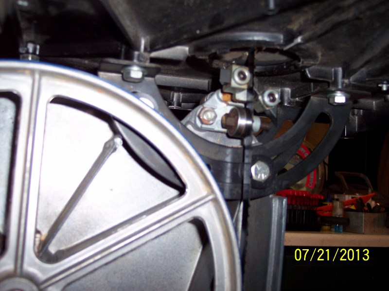

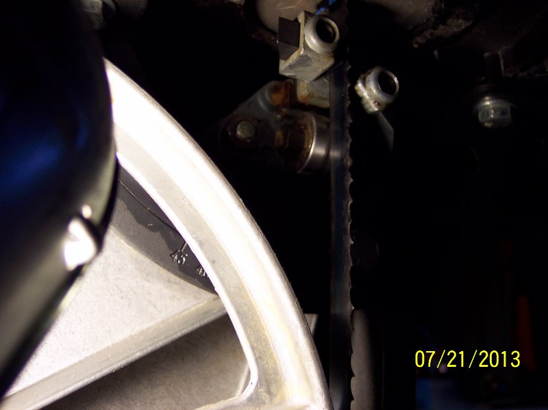

blues revisited...pictures !!!
I finally got around to snapping a few pictures of my band saw accomplishments...comments accepted !!!
[ATTACH]22250[/ATTACH]
[ATTACH]22251[/ATTACH]
[ATTACH]22252[/ATTACH]
[ATTACH]22253[/ATTACH]
- closeup of backup bearing (800x599).jpg (112.55 KiB) Viewed 3694 times
- closeup of lower bearing (800x599).jpg (110.29 KiB) Viewed 3696 times
- front bearing closeup (800x599).jpg (140.16 KiB) Viewed 3701 times
- side view showing blade tracking on two bearings (800x599).jpg (142.54 KiB) Viewed 3698 times

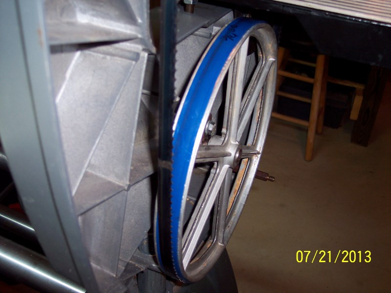

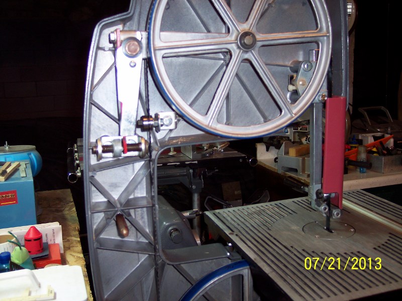

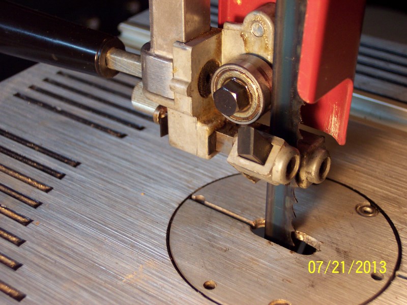

blues revisited...more pictures
More pictures of tire replacement and of band saw adjustments...
[ATTACH]22254[/ATTACH]
[ATTACH]22255[/ATTACH]
[ATTACH]22256[/ATTACH]
[ATTACH]22257[/ATTACH]
- view of bearing on bottom with blade tracking (800x599) (2).jpg (135.42 KiB) Viewed 3697 times
- undertable perspective of roller bearing (800x599) (800x599).jpg (80.06 KiB) Viewed 3696 times
- tracking of new blade on lower tire (800x599).jpg (105.03 KiB) Viewed 3700 times
- blade tracking on bearing at cutting level (800x599) (2).jpg (119.79 KiB) Viewed 3695 times
It looks good from the camera angle, but the upper guide backup bearing should barely CLEAR the back of the blade, and only contact it under cutting pressure.
Interesting tire 'color'.
tire color...
Tires are from a company that supposedly makes these "exclusively", found the link on Ebay. I'm attaching a copy of the ad where I bought them...JPG40504 wrote:It looks good from the camera angle, but the upper guide backup bearing should barely CLEAR the back of the blade, and only contact it under cutting pressure.
