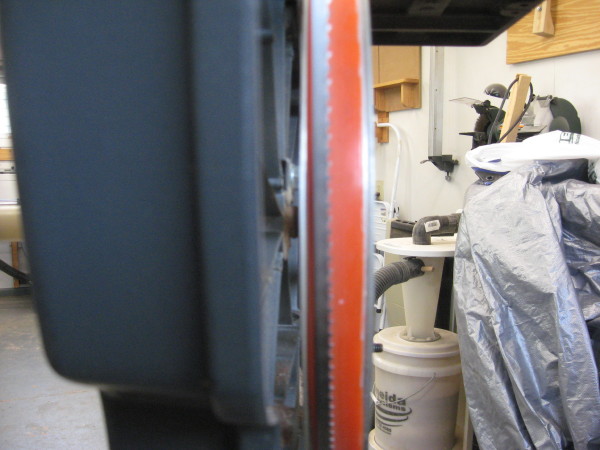

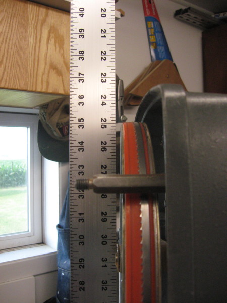

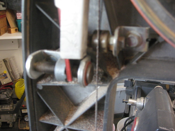

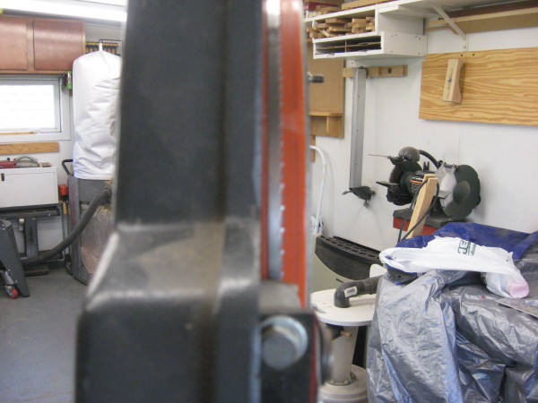

Will attach some pictures to show what my machine looks like..
Bought off craigs a few years back. replaced the three roller bearings, and installed urethane tires otherwise have not touched it. What you see in the poor pictures is where the blade runs, and it seems to work just fine. I usually run the blade tighter than the indicator shows. otherwise the blade seems to loose......[ATTACH]22096[/ATTACH]
[ATTACH]22097[/ATTACH]
[ATTACH]22098[/ATTACH]
[ATTACH]22099[/ATTACH]

I appreciate the come back so quickly. I was thinking that my next move would be to check the "tracking" of the top tire, and your pictures seem to confirm this.
I think it is also wise to tear everything down, check for wear, attempt readjusting alignment of upper tire, then move on from there. At least this could be my starting point. I'm not in a hurry to use this thing, just now, but want to get it "right" so I can use it...if the bearings need replaced in my wheels, then that is something else also. This machine wasn't abused, but I believe it was just neglected...
I will make an effort to tear everything down again, soon, and take pictures as I move along, just in case I have a glitch, then I can revisit here and get ready to do some adjusting...
