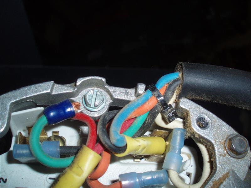

There are six wires in the Crafter's Station cable that all terminate in the motor.
Note that the red wire comes from within the motor (not from a terminal block). Also note that the black and blue wires are connected together.
The two yellow crimp connectors that I used here are inappropriate parts for what they are being used. One does nothing more than connect the two red wires together. The other does nothing more than connect the blue wire to the black wire. There are NO Wires connected to the other ends of these splices.

Our wiring is different. We have the six wire cable harness while your photo shows just three wires coming down from the upper controls. That's confusing because your other diagrams, such as the relay diagram, indicate that we should see orange, blue, and red wires down at the motor as well.
Here's the mess I came home with...

I'm sorry, Dave, for the confusion that I have caused by posting a picture of the wrong motor configuration. I have posted, later in this thread, the picture that should have been here.

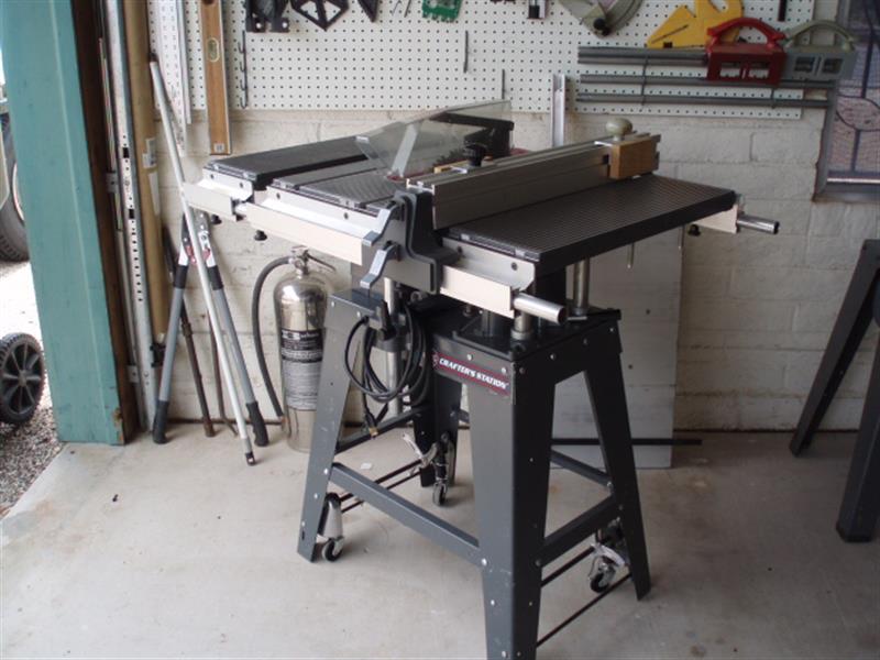

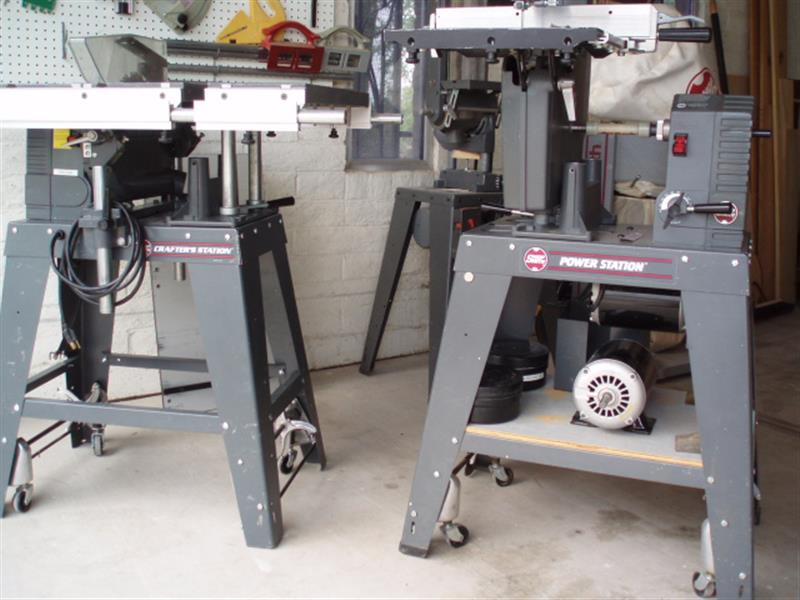

A crafter's station is a power station with a saw table(510 vintage). It is under powered for the saw function, but does provide that function.
Power station http://www.shopsmith.com/ownersite/catalog/powerstation.htm
The crafter's station is no longer in production.
fightingseabee wrote:forgive my ignorance I am new to SS, what is a Crafter's Station.
The Crafter's Station is said by some to be under powered as a table saw but that is a matter of opinion and is dependent upon what you need to cut. From someone who owns one, I find it to be a very useful power tool.
I occasionally need to do typical woodworking around the kids homes (none of them have shops yet). I load the Crafter's Station into the pickup and go. The SPT that work with the Mark V can be used with the Crafter's Station (or Power Station)]22497[/ATTACH]
