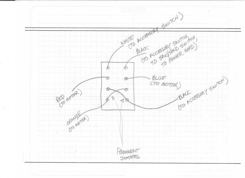

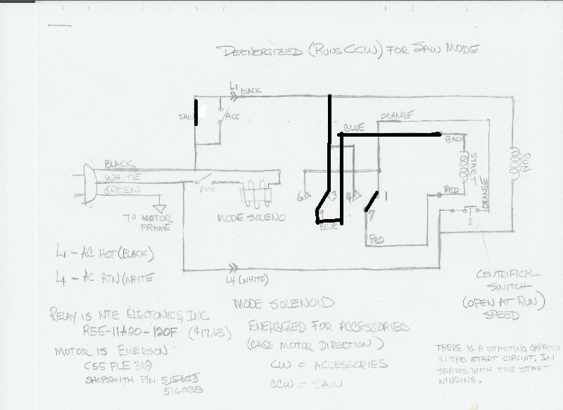

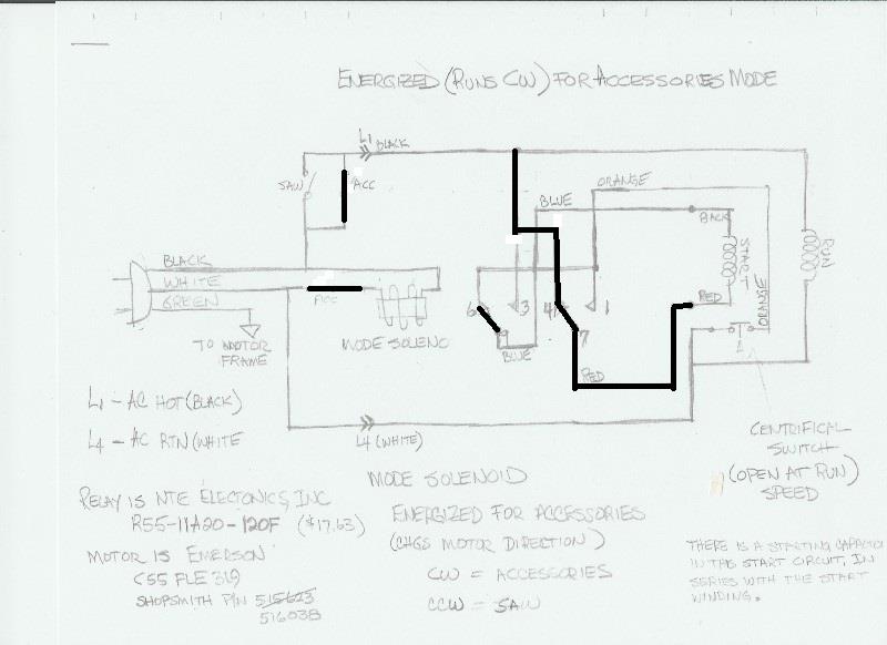

I too fought that diagram. I have the solution but I'll have to locate it. Hopefully sometime later today.
I'll confirm which motor I have then.
I hope you have as much success with yours as I have. I think it is a shame that they did not produce this in numbers.
Posts: 21481
This may be all I have that might be useful but I'll keep looking.
[ATTACH]22491[/ATTACH]
[ATTACH]22492[/ATTACH]
[ATTACH]22493[/ATTACH]
Corrected Drawing (Deenergized) (Custom) (2).jpg (39.68 KiB) Viewed 2565 times
Corrected Drawing (Energized) (Custom) (2).jpg (39.96 KiB) Viewed 2567 times

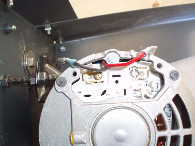

These might help.
[ATTACH]22481[/ATTACH]
Power Station Motor with all wires connected.
[ATTACH]22499[/ATTACH]
Power Station motor highlighting Start Winding Connectors
[ATTACH]22480[/ATTACH]
Spec Sheet for "Mode Control Relay"
CAUTION: It has been pointed out that this is NOT the wiring for the CRAFTER'S Station. It is the same type motor but does not have the same cable.
In this diagram, however, you can clearly see the Black and Red wires descend down into the motor. Reversing those two connects will reverse the direction of that motor. Those two wires that disappear into the motor are the connections to the start winding.
R55-11A20-120F.pdf
(88.54 KiB) Downloaded 345 times
P3240011 (Custom).JPG (57.4 KiB) Viewed 2667 times
Start Winding Connectors.JPG (137.69 KiB) Viewed 2540 times

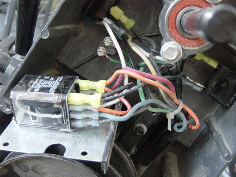

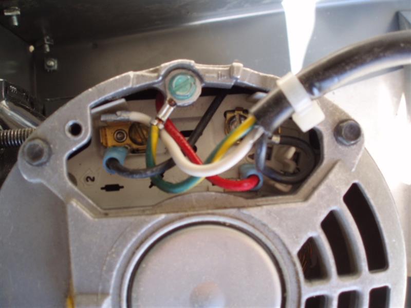

Hi Dusty,
Thanks for the help!
Our wiring is different. We have the six wire cable harness while your photo shows just three wires coming down from the upper controls. That's confusing because your other diagrams, such as the relay diagram, indicate that we should see orange, blue, and red wires down at the motor as well.
Here's the mess I came home with...
-Dave
Posts: 21481
dstensland wrote:Hi Dusty,
-Dave
I'll double check the photos. The cable that I use is a Shopsmith part (specifically for the Crafter's Station). The wiring diagrams are my interpretation of how it is wired.
Mine works!! That is to say that when both switches are off, nothing runs. One switch on the motor turns one direction](first switch off)[/SIZE] the motor turns the other direction.
The cable has six conductors: blue, black, white, green, red and orange. The orange wire is tucked in nder the motor end cap and can barely be seen in the photo but it is there. No, it is not - wrong motor shown here.

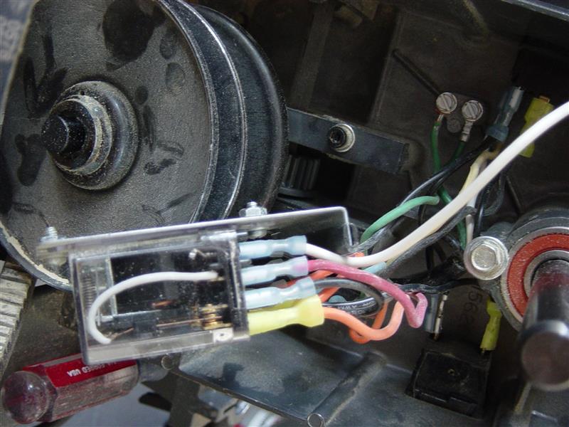

Do you have the 'reverse' relay, and where is it located
(off the motor?).
If you have an ohmeter capable of distinguishing between near zero and 5 ohms, the correct wiring can be determined.
Posts: 21481
Two views of the "reverse relay" (aka mode select relay).
[attach]22483[/attach]
[attach]22484[/attach]
More to follow but I am having internet problems again. Later.
wires2 (Custom).jpg (73.5 KiB) Viewed 2614 times
wires3 (Custom).jpg (81.48 KiB) Viewed 2621 times

Dusty and JPG,
Thanks for the help. I really appreciate it!
This evening I dug deeper and confirmed that the wires are indeed hooked up the same as Dusty's... at least around the relay and switches. That's when I noticed that the reversing relay was buzzing and arcing was present with the accessory switch in the on position. I wasn't able to hear that sound before because it was hidden behind the noise of the belt and pulley commotion.
So, I removed the relay and simply applied 110VAC directly across the coil, leaving the other contacts open. Instead of clicking on as expected it just buzzed like before. The coil is not pulling in as it should. I suspect it's just bad. The coil is reading 1.6K ohms.
In the interests of contributing back to the group, I actually used a digital microscope to magnify the tiny diagram found on page A-13 of the Crafter's Station manual. I then compared that to the actual connections on my motor. The proper motor-terminal-to-harness-connection-colors listed in the manual are...
#1 - black
#2 - red
#3 - blue
#4 - white
#5 - orange
motor chassis - green
However, the motor terminal area on mine doesn't have #2 or #3 terminals. Instead, red and black wires are surfaced from behind the motor terminal area and are connected to the harness as follows...
red motor - red harness (Assumed to be equivalent to #2... not sure)
black motor - blue harness (Assumed to be equivalent to #3... not sure)
Guess I'll order a replacement relay (NTE R55-11A20-120F) and report back after it is installed.
Thanks again,
-Dave
Posts: 35441
My guess as to some confusing pix/posts.
1) Dusty's pix is of a power station motor
2) Dave's pix is of a power station motor installed in his crafter's station.
3) The power station motor has the red and black wires, but they are connected to only run one direction(see Dusty's pix).
4) I think your assumptions re terminals #2 and #3 are correct.
5) I think you have the determined failing part, but have not yet determined the cause.
IIWM, I would be taking the relay apart to determine why is is not picking. It may have something interfering with the armature sealing. It may have crudded up pivots. It may have a damaged coil(burned etc.).
