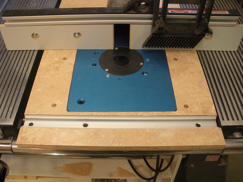

Post by hjlssfor1 »
Yesterday I cut in a miter slot in the front of the table so that I can use a feather board to help hold the workpiece in place:
[ATTACH]23130[/ATTACH]
