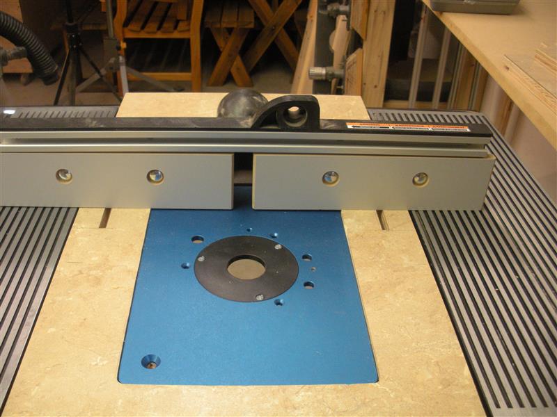

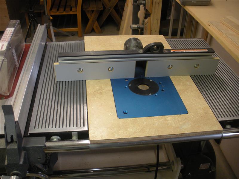

The two attached images show a router table insert I am building that will hang off the rails of my Shopsmith (thanks to Shipwright for the inspiration on this). I am trying to reuse (on my Shopsmith table) the fence from a Skill router table I have.
[ATTACH]23089[/ATTACH]
[ATTACH]23090[/ATTACH]
To mount the Skill fence on my Shopsmith table, I must cut two through grooves in my Shopsmith table top, which is ¾” ply with a formica top. The through groove cut will run for 15 – 16”, and needs to be 5/16” wide. The groove (one above and one below the router plate insert in the photos) will start at the line starting at about the left side of the black insert plate and run left to within about 3” of the end of the table top.
The first image gives you the overview, and the second image shows the approximate cut line for the through grooves.
I am a beginner at woodworking, and I am not sure how to cut those grooves. What advice can you give as to technique/s to make the groove cut? Is this a job for the table saw dado blades, a handheld router, or something else?
Any counsel would be appreciated.
Hank

As I think more about this, I do not need the grooves to run as far in distance as I said in my original message. I expect that 3 or 4" would be plenty (I do not intend to be using huge/wide router bits!).
My question as to cutting technique still stand, and I would appreciate any ideas on how to cut the groove.

I finally got to the shop this afternoon, and took a few photos. The first shows the overall plan to use the fence from my Skill router table. It has a dust port, a t-track, and movable fence pieces that adjust to the size of the router bit.

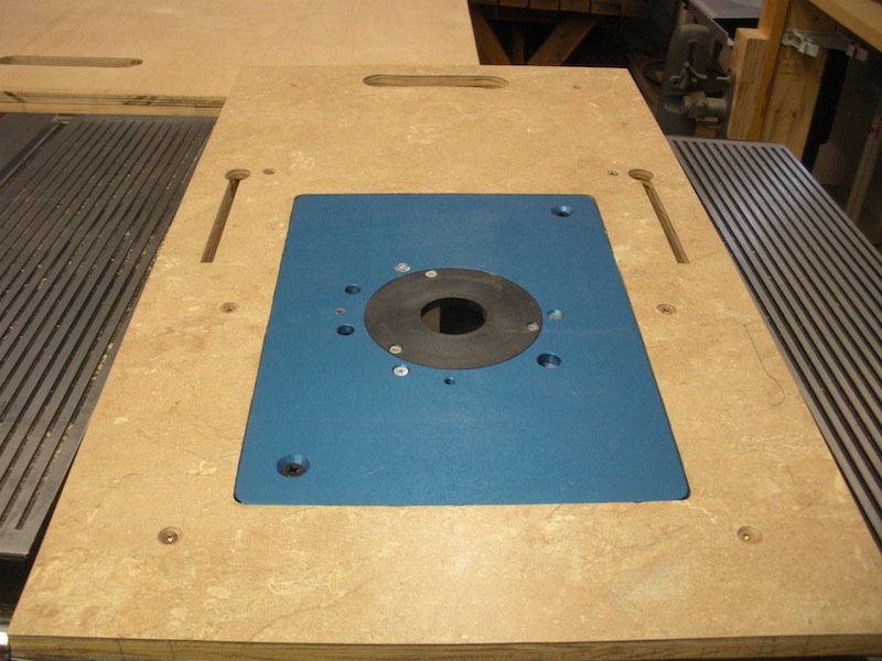

I had the time to cut the grooves for the fence:
[ATTACH]23107[/ATTACH]

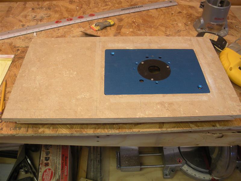

This shows the hardware for adjusting the height of the Rockler base plate I installed:
[ATTACH]23108[/ATTACH]
