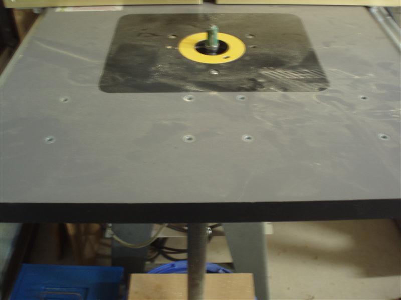

Questions about 555995 Router Table
Dusty,
You mentioned an something in your post about the 555995 Router Table about topside feather boards being able to be used. I could use some help in illustrating this point. How that works is not apparent to me.
Also, have you considered installing a T-Track to enable a miter gauge to be used?

wdelliott wrote:Dusty,
Thanks.
The table is equipped with threaded inserts that can be used to mount feather boards. Attached is a photo that shows those inserts. (sorry about the poor quality picture)
[ATTACH]17951[/ATTACH]
