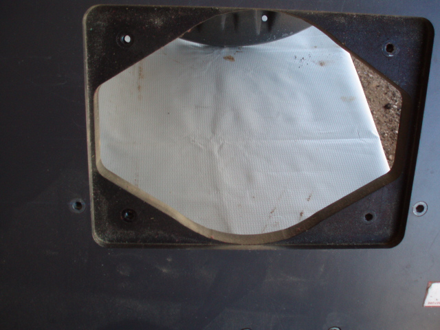

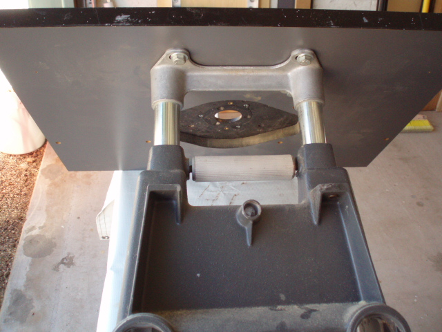

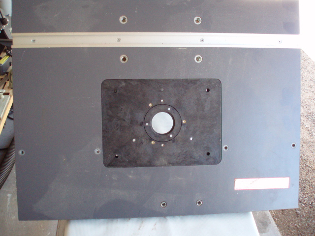

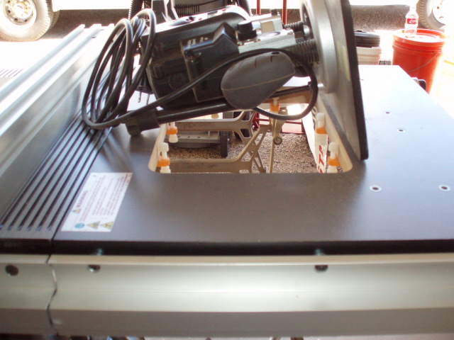

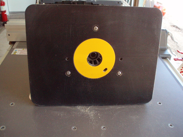

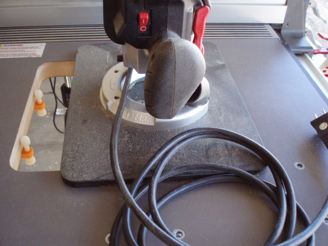

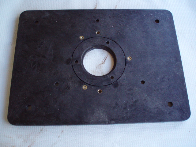

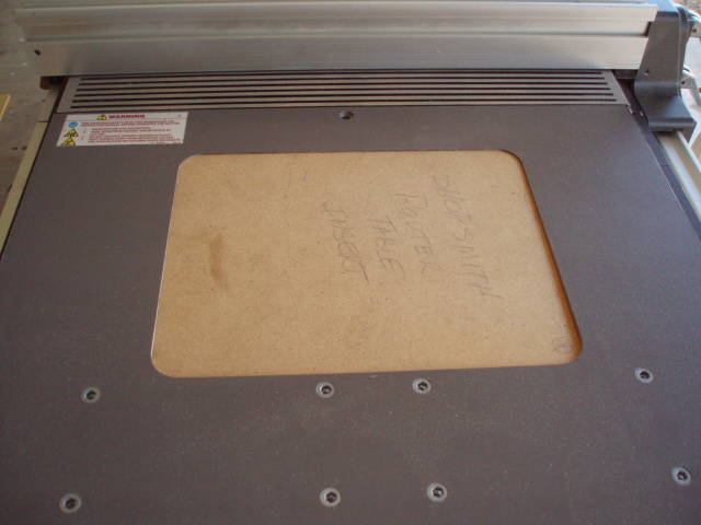

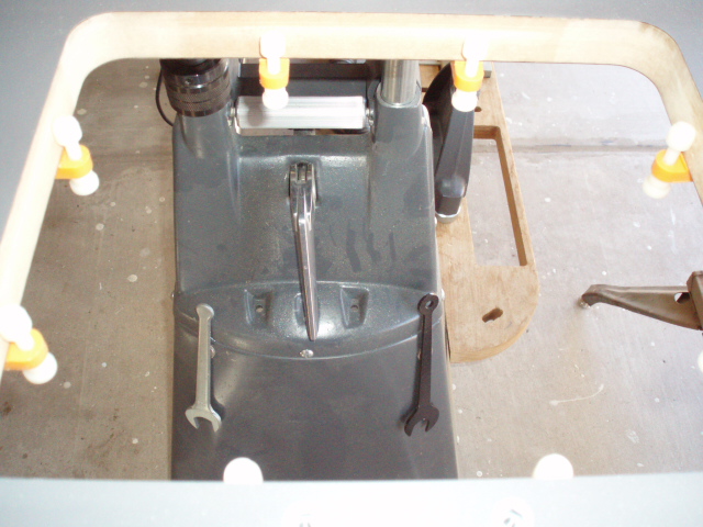

555658 Mounts to the Shopsmith using an extension table base. It measures 23 13/16 x 18 3/16 and is about an inch thick (thinner than 521962). However, mine is about 12 years old and it has not warped. I like it partially because it has the t-slot for feather borads, etc. The router shield also mounts to it (and to 521962).
521962 is equipment with 520 rails and has no t-slot. It is thicker but I am not sure that has bought me anything. It will also accept feather boards and the router dust shield.
Both have router table inserts to which you mount the router. 521962 does use the woodhaven insert. The other insert is of a similar material.
521962 has adjustable router levelers while 555658 employs shims.
I'll posts pictures of 555658 with this post and will put the others on a subsequent post.

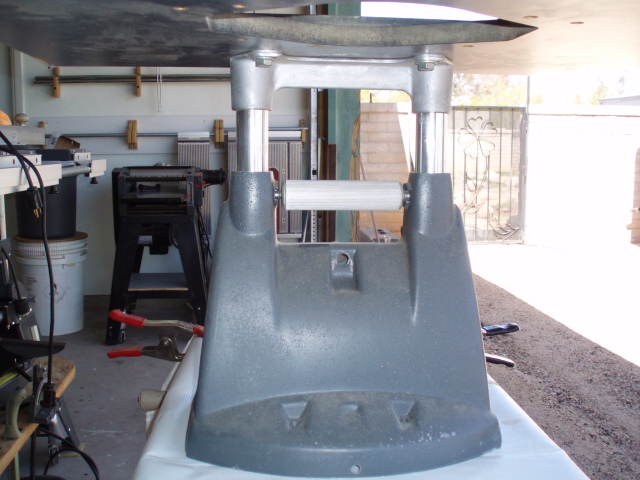

These photos along with those on a previous post will, I hope, answer your question regarding the two router tables.
Incidently, neither one uses any sort of clamp for either the router or the router insert. The inserts are dropin and the routers attach to the insert with screws.
