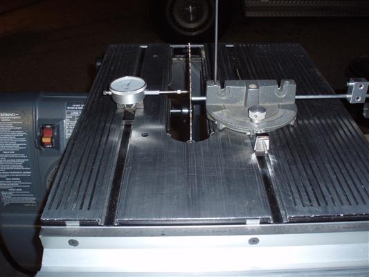

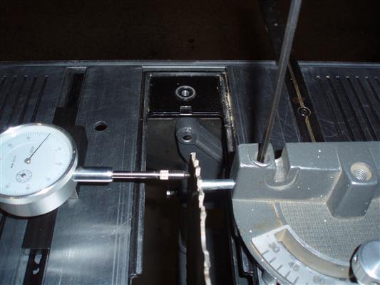

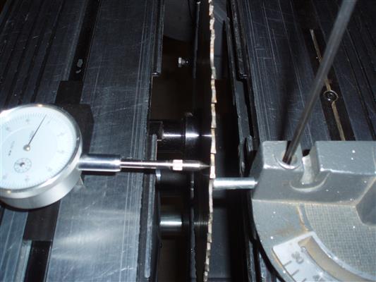

I will but please remember that these are all just my opinions. Furthermore, this all depends on just how precise you believe you need to make the table alignment.
The table can be aligned to the blade with no special tools or you can make like this is a precision alignment and use the dial indicator. Repetition, using which ever method you chose, will make this alignment a simple routine experience. However, whatever method you use, once aligned the way you want it I believe you will find very little need to realign. The table maintains alignment very well.
If you have not already viewed the Sawdust Session on table alignment, I think you should. The tip regarding use of a dollar bill is a good one to follow.
If you think about how Nick uses the dial indicator in this video, you will realize that all he is doing is attempting to make the distance from the saw blade to the miter slot the same at both the infeed and outfeed side of the blade. He uses the same tooth location for these two measurements as a way of compensating for any wobble that may be in the blade.
If the blade is perfectly flat, this is an unnecessary detail. I have one blade and arbor that I treat as my "gold standard". It is nearly flat (it is flat enough) and I do not bother rotating the blade.
These images depict three different ways that this alignment can be performed with equal levels of precision.
[ATTACH]23285[/ATTACH],[ATTACH]23286[/ATTACH]
[ATTACH]23287[/ATTACH],[ATTACH]23288[/ATTACH]
Three of the images depict two of the procedures (using a dial indicator or the miter gauge and a rod).

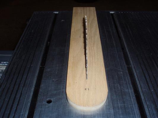

The last picture depicts a zero clearance insert used to do the same procedure. The ZCI was cut when the table had just beed aligned using the dial indicator. If the table is properly aligned when the ZCI is dropped down over the blade it should seal into the cutout perfectly. If the table is misaligned, the ZCI will not seal into the cut out.

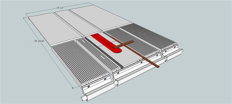

Main Table to Blade Alignment or Verification.
In a previous thread, this same subject was discussed with a couple other twists.
With a blade installed, the jig should just barely fit and when moved back and forth some drag (but no binding) should exist between the blade and the fixture..

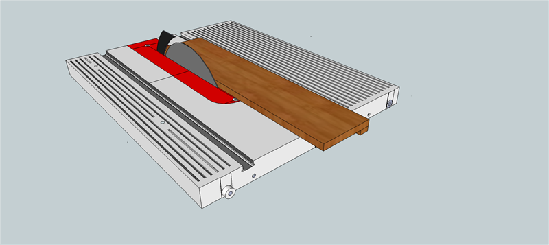

Still another method..
[ATTACH]23317[/ATTACH]
Main Table Alignment Jig with Blade (Custom) (2).png (108.69 KiB) Viewed 5299 times
Main Table and Two Floating Tables with Outfeed Table (Custom).png (122.36 KiB) Viewed 5297 times

I would (and do) use a broader foot on the dial indicator. The pointed foot will read variations and knicks in the surface of the blade such as rust and dirt. The broader foot will bridge over these variations and average the readings. My saw blade has a textured finish just under the teeth and that finish is actually .002 higher than the blade body. Also make sure that you measure to the same spot on the blade body in the front and the back of the cut line. I seem to recall that there were some instructions about determining the max runout. It said to measure the width of the kerf and then measure the thickness of the sawblade body. Take the difference of those measurements and then divide by two. This is supposed to be the maximum runout that is permissable before the outfeed side of the blade will start to contact the workpiece and possibly cause a kickback.

Technically you are absolutely correct. Especially important when doing extreme precision work. Taking into consideration the variations in the surface gets to be "extreme precision". Tighter than my tolerance levels.
As for using a pointed tip on the dial indicator, I have chosen to use the ball tip because it slides on the reference surface. The sharp tip scatches and digs in which necessitates lifting it off when moving the dial indicator.
