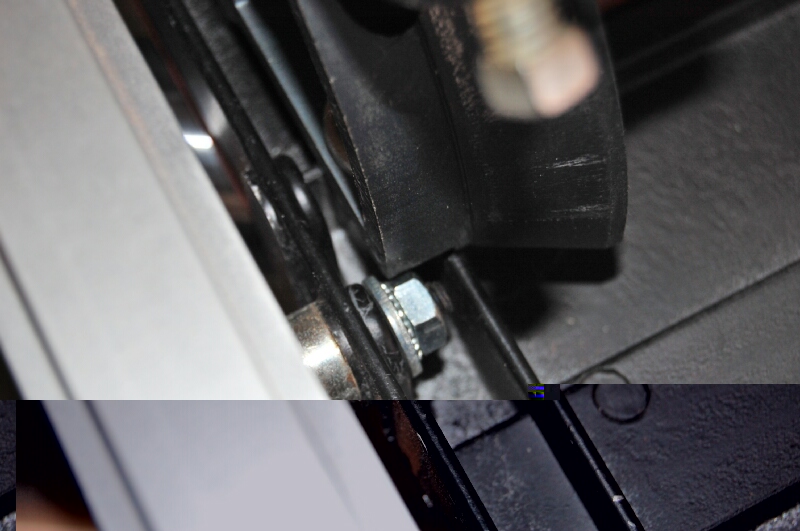

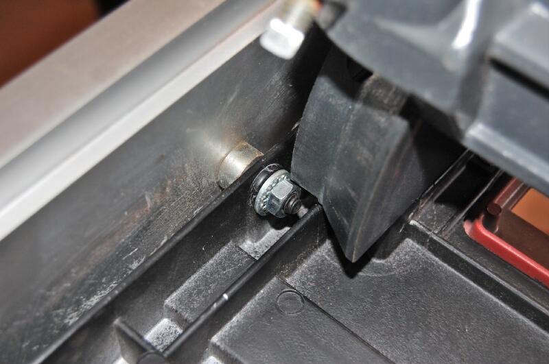

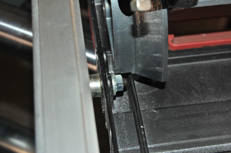

Somethings I did discover while doing the alignment for which I see no work around are this. Two problems really. First while the front trundle (in feed side) has slightly over sized bolt holes for wiggle room, the rear trundle (out feed side) does not. Both holes are just large enough for the bolts to slip through allowing next to no wiggle room. Secondly, there is a table railing nut directly up against the Headstock side of the rear trundle which further restricts movement on that side.
Yesterday I only used Nick's way, loosening all of the trundle bolts then snugging the rear right (opposite the Headstock) to act as the pivot. This morning I awoke wondering if maybe I should try again but snugging rear left bolt (headstock side) instead since this is where the railing nut interferes with the trundle anyway.

I think .005 is acceptable. As to the trunnion bolt holes, this has been discussed before. Shopsmith'a position is that this is a manufacturing defect and if you call them they will authorize a return and redrill the smaller holes to match the larger. Alternatively, several of us have done the fix ourselves. I can verify that alignment got much easier for me after I redrilled my trunnion.
As to the railing nut interference, I don't have a recall of any such issue on my 520.
As to which trunnion bolt to leave snug, I don't think it matters.

Here are pictures of the railing bolt/nut issue.
[ATTACH]23281[/ATTACH]
[ATTACH]23282[/ATTACH]
[ATTACH]23283[/ATTACH]

If you have it aligned so that the blade is parallel to the miter slot to within .005", I would "quit". You'll not get it much better.
Since you have a trunnion that has been declared "out of spec", I would call Shopsmith and negotiate a replacement (with the defective one to be returned to them). If they will go along with that, you have no down time.
I too have a table rail nut that is very, very close to the trunnion but it does not interfere with alignment.

After I enlarge the holes, do any of you think the rail bolt/nut against the left side of the trunnion will still be a problem? As it is, it certainly minimizes travel to the left.
