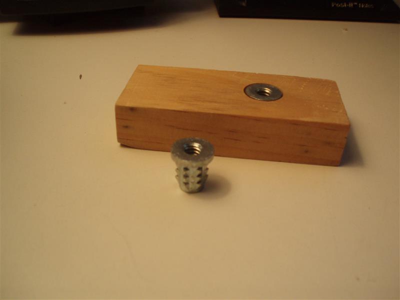

The latest threaded inserts I bought use a hex drive (EZ-Lok) so I just insert the short end of the allen wrench to get the torque to install. Not ever used the drill press or driver to install but seems like a good idea. Predrilled hole seems to keep then on track.
I have a couple lengths and threads of insert so I use one that is as close to the thickness of the material as I can. I use one for MDF that almost looks like a series of propellers. I add a dab of epoxy when I insert it. None have ever pulled out

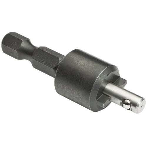

That tools to insert the ones that can use a screw driver is this
http://www.amazon.com/Power-Drive-Threa ... ed+inserts
[ATTACH]23501[/ATTACH]
I used a flat blade screw driver with no problems but when I ran out of those inserts I switched to the hex drive ones. I "can" see a good reason to use the nice brass ones if you have blades that might nick the insert.

benush26 wrote:The latest threaded inserts I bought use a hex drive (EZ-Lok) so I just insert the short end of the allen wrench to get the torque to install. Not ever used the drill press or driver to install but seems like a good idea. Predrilled hole seems to keep then on track.
