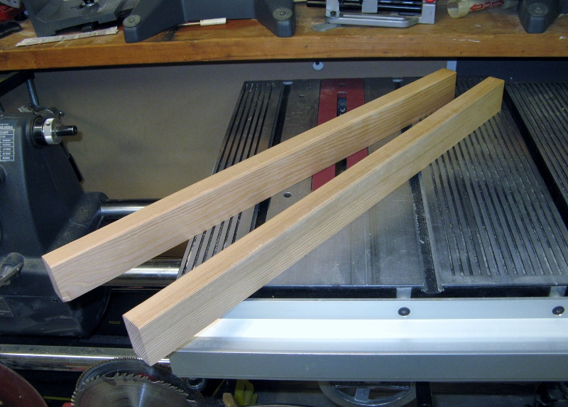

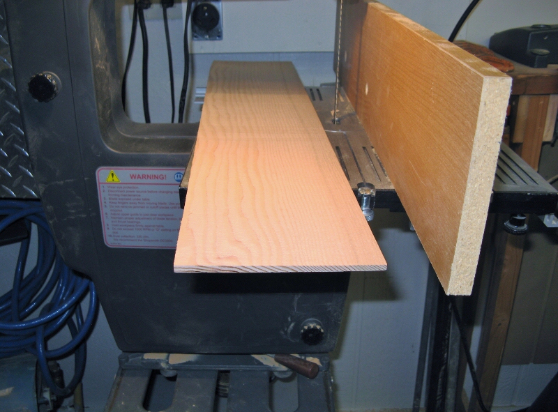

I found this thread interesting. I have a 5 x 8 in oak timber I want to use for a leg vice ( a someday project). For the leg vice project I have been considering purchasing a special band saw blade.
Anyway yesterday I needed two pieces 1 3/32 x 2 3/16 in rather than using the planer to size a re-purposed 2 x 6 board I used the SS band saw with a 1/2 in SS blade to re-saw the board. I am more than happy with the results. As a bonus I now have a 5 1/2 x 1/8 in thick board I can add to my "you never know pile". The following two pictures show the results.
[ATTACH]23734[/ATTACH]
[ATTACH]23735[/ATTACH]
