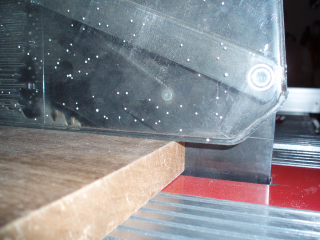

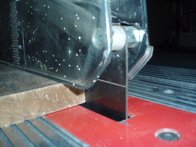

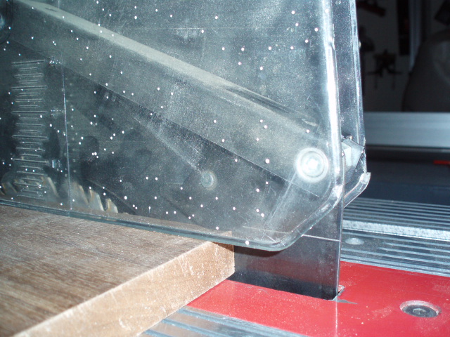

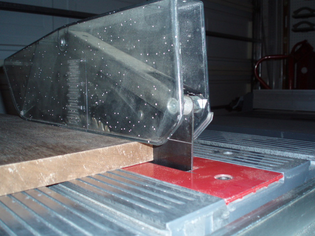

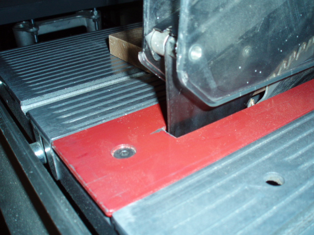

chrispitude wrote:When I pretend to run a workpiece underneath the clear upper guard, it's hanging up on a ridge of clear plastic at the two back vertical edges of the guard. Those ridges catch on either the pivot pin in the back, or some sharp metal edges back there. Maybe I need to take a picture to explain what I mean. I'm thinking the easiest fix is to shave off those plastic ridges with a utility knife, but it seems strange that I would have to do this on something brand new (and expensive).
I don't feel like I was able to explain this very well, so I took some pictures. The ridges along the back ends of the upper saw guard like to hang up here:
on these sharp corners of the rear of the metal arm
on this pivot pin
Is it normal for them to do this?
I'm also hoping someone can confirm that the grabber arm on the rear of the 520 fence is supposed to be crooked as in my previous picture.
Thanks all!

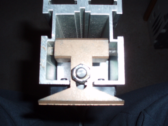

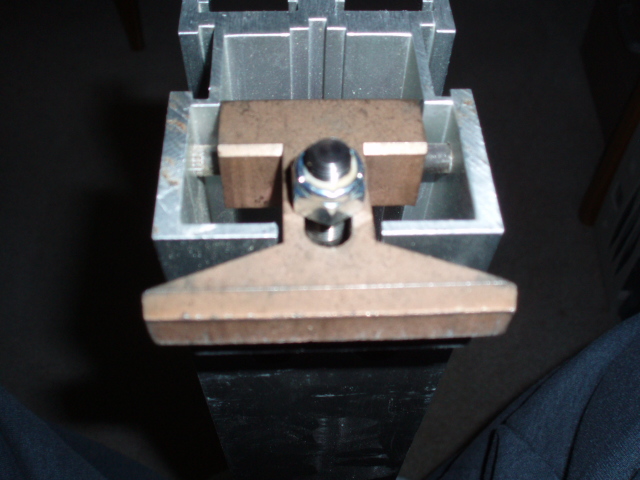

Hi,
The back of my rip fence doesn't look like that. Something may have gotten bent in transport. That piece needs to rest on the back rail piece and grab cleanly snugging up the fence. If it is damaging the back rails by trying to clamp at an angle then for sure you have problems. Without having it in hand to look at I can't for sure tell but I would give shopsmith a call and have the parts in hand so you can explain to them and they can reply with ideas. If parts are damaged get on it right now so you can be up and running sooner. You might want to get some pictures of the rails, they too might have been wrecked when you clamped down.
On the second item, the edges or what ever is catching on the clear guide should not be doing that. Tweeking the corners very lightly with a pair of pliers might fix that or if it is a burr then a couple of swipes with a file can get rid of that. Everything should move smooth.

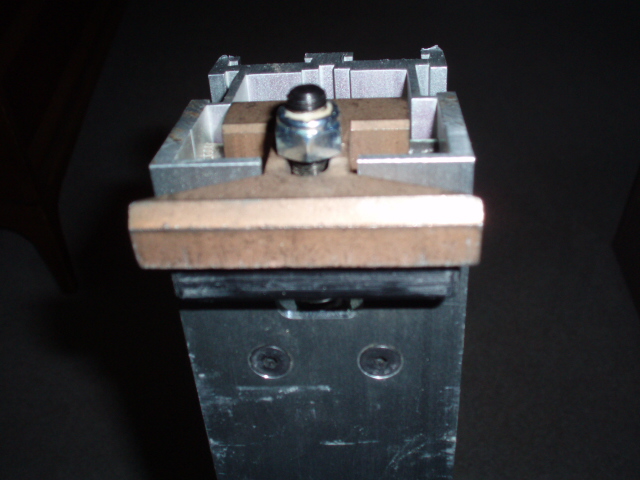

Chris,
I'm attaching a couple of photos here to show how my rip fence looks and I'll do a second post to discuss the saw guard.
It does appear that your rip fence might need to be "reassembled" to get the proper alignment on the piece that grabs the rear rail.
The rail is tapered on the edge and the mating piece on the rip fence has a matching reverse taper. These should slide together tightly but SMOOTHLY. The mating edges must be parallel to one another.
Finally...my 500 to 520 upgrade experience
Chris,
The photos attached here deal with the saw guard.
I am unable to see how your saw guard is any different than mine. I believe mine has the same jagged edges as yours.
The photos that I have included were taken with a piece of 3/4" stock slide under the guard (to the right of the blade). I believe this is what you did as well.
I'm sorry I can't help here. I have no suggestions.

dusty wrote:The rail is tapered on the edge and the mating piece on the rip fence has a matching reverse taper. These should slide together tightly but SMOOTHLY. The mating edges must be parallel to one another.
Hi dusty,
Thanks for responding. It sure looks like your rip fence does NOT look like this:
I guess I got (pic 1)
a Friday (pic 2)
rip fence, huh? (pic 3)

dusty wrote:I am unable to see how your saw guard is any different than mine. I believe mine has the same jagged edges as yours.
Hi dusty,
That is precisely what I did. It looks like yours hung up the same way mine did? Since reible's guard falls back down freely, I am guessing ours is not intended to hang up. I'll also ask Shopsmith about this on Monday and share what they say. If they have no suggestions to address it, I may just trim that ridge off both sides with a utility knife and see if that helps.
Chris,
I'm not sure we are in concert. If I pull the stock out, the saw guard will return to the table top. It does not hang up. It moves up and down very freely.
