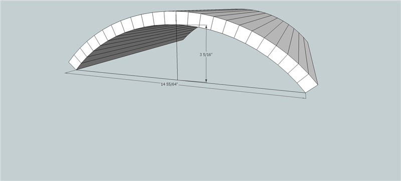

It has been said that this will not work but I cannot come to that conclusion because I am lacking information . I don't know that height or the the width of the arc.
The dimensions that have been given would result in a arc that is 14 55/64" wide and 3 5/16" high.

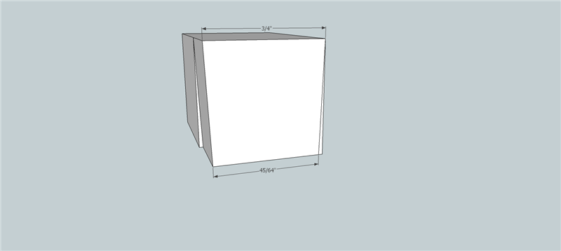

Tilt the table 2° right and cut one edge. Flip the work piece end for end, keeping the same surface on table as before. Move the fence to get the 3/4" width and make the second cut.
It is imperative that the work piece be held tight against the fence. You need not ask how I know this. I cut a couple pieces to see how this would work. I used two push blocks. One feeding the piece and the other holding the piece tight to the table. This would be the right place to use a feather board.
[ATTACH]24112[/ATTACH]
The width of the slat, cut the way I did it, will be 45/64" if the slat is 3/4" thick and the angle is the same 2°s as I used. The accuracy of the tilt will obviously alter these measurements. What is shown here is dead on 2°. I would not expect to exactly duplicate these dimensions in the real world of saw dust.
[ATTACH]24117[/ATTACH]
I used a Wixey to measure the table tilt and the adjustable stop collar to make the necessary adjustments.

What is the height and width of the arch?bear1050 wrote:Chuck thanks for the input but not sure that would work as this is for a curved top for a chest and I think it needs the cuts on both sides of the slat. See attached diagram.
