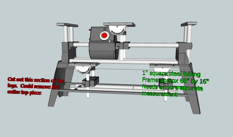

Dusty's new table using mostly Shopmith parts
PLEASE NOTE!!
The original drawing of the Mark V is NOT MINE. I downloaded it from the Trimble site
THANK YOU TO THE CREATOR.
Using a couple extra Way tubes and two carriages (with or without tables) and about 20' of 1" square steel tubing, I think we can create a height adjustable Shopsmith. The tables or trunnion parts could be attached using any wide variety of clamps as could the Way tubers to the steel frame. If you wanted to complete Shopsmith authentic, I would guess you could use the Lift assist clamps.
Voila
[ATTACH]24196[/ATTACH]
Please note that in the drawing the way tubes are IN the frame not ON it, but I was not about to try and finesse all the pieces into EXACT position.
Also I could not adequately remove the section of leg to show the complete removal, but did show an ESTIMATION of what could / should happen.
If you cut the legs at their lowest level and removing the rest I think it would result in about an overall 10" table height reduction. If you are taller and want the table higher, removing about 4" of leg would probably work for you, HOWEVER!!!
WHERE YOU CHOOSE TO SET THE FRAME WILL DETERMINE THE RELATIVE WORKING HEIGHT SO FIGURE CAREFULLY!!! The higher you set the frame the shorter and narrower it will be (to fit the taper of the legs) Someone with access to their machine will need to determine the height of the carriage and table at it's most compressed. Knowing that will allow you to figure the amount of leg to remove. Height of the adjusting assembly (top [table or trunnion] to bottom of the carriage) minus the amount you want to reduce the final saw table height is where the top of the frame should be positioned relative to the existing bases. (Getting tired so hope that makes sense! )
1. Measure the inside of the legs (somewhere above the casters) to obtain your frame size. If you cannot weld it or have someone weld it, I would presume that it could be fabricated using drilled hoes and nuts and bolts.
2. Set the frame inside the legs parallel to the floor, mark and drill the legs and frame so you can use nuts and bolts to hold it in place. Personally I would have a at least 4 bolts per leg, probably two on each side to help deflect any stress. Attach the frame or wait until you have sawed off the legs and attach later.
3. Mark where to cut the legs above the frame
4. Whether you turn your Mark 5 (7) upside down or suspend it, remove the legs and cut them
5, If you have yet to install the frame, do it now.
6. Take the two Way tubes and install the two carriages so they are near the ends of the tubes but within the interior frame bracing.
7. Set the tubes on the frame and secure. (However you may choose.)
8. Insert the tables, set down to the bottom position and tighten the locks, You want the tables all the way down so there is as little deflection as possible within the frame and what's left of the legs. when you set the Shopsmith on them
9. Set the Shopsmith on the tables, center left and right and front and back and find a way to secure. Personally that's where I think the Lift assist clamps would work well. Drilling the tables where needed.
I think that's it.
A Shopsmith Mark V 500, 505, 510, 520 and Mark 7 adjustable to the users preference with compromising the integrity and safety of the original design.
Tell Shopsmith I'd like my check!!:D
Be well,
Ben

I "think", that if the two table adjustable support system were to be used, by initially releasing the trunnion locks and raising the right side (and then re-tightening ), the length of a beveled cut might be extended beyond where it now exists.

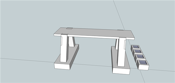

Adjustable Height Mark V
In post #4 I presented an idea for how to lower the Mark V for short people like me.
This update is in keeping with the discussion of an adjustable height Mark V.
[ATTACH]24200[/ATTACH]
- Saw Horse With Risers.png (33.93 KiB) Viewed 3040 times

Now, I’]I[/B] see considerable potential for issues regardin’ structural integrity and operator safety. (I suspect the suspect ingredient in this contraption to be rum but, being a whiskey man myself, I’m no expert.)
Having to align two tables if you need to adjust the height could be a headache.
Seems to me that the best way to tackle this concern is with a platform or to remove the legs entirely and place the whole works (sans legs) on something else that allows for its height to be adjusted.
Of course I’m also not a big fan of chopping up the original goods. Probably because I only have one good to chop if choppin’ urges should arise. Maybe I’ll find myself a raggedy machine that I can subject to my merest whim one day.
