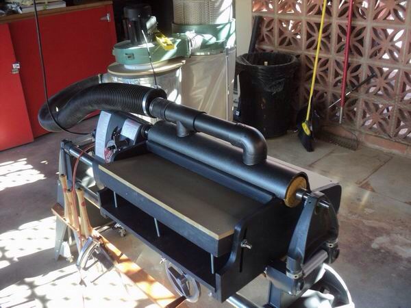

24" Flatmaster adapted to Mark V

Looks a lot like mine. There is a whole build blog here. http://lumberjocks.com/shipwright/blog/series/4552
It is also posted on this forum here http://www.shopsmith.com/ss_forum/viewtopic.php?t=9382
and here http://www.shopsmith.com/ss_forum/viewtopic.php?t=9972 complete with video.

Yes they are very similar. I saw your youtube which is very cool. I noticed that you have the speed reducer on yours. There have been a number of times I would have liked to go slower. What did you use for drums ?

No speed reducer. The drums are PVC. It's all in the blog. I run at "drum sander" speed.
