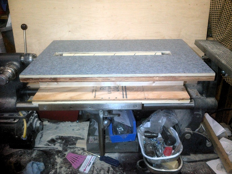

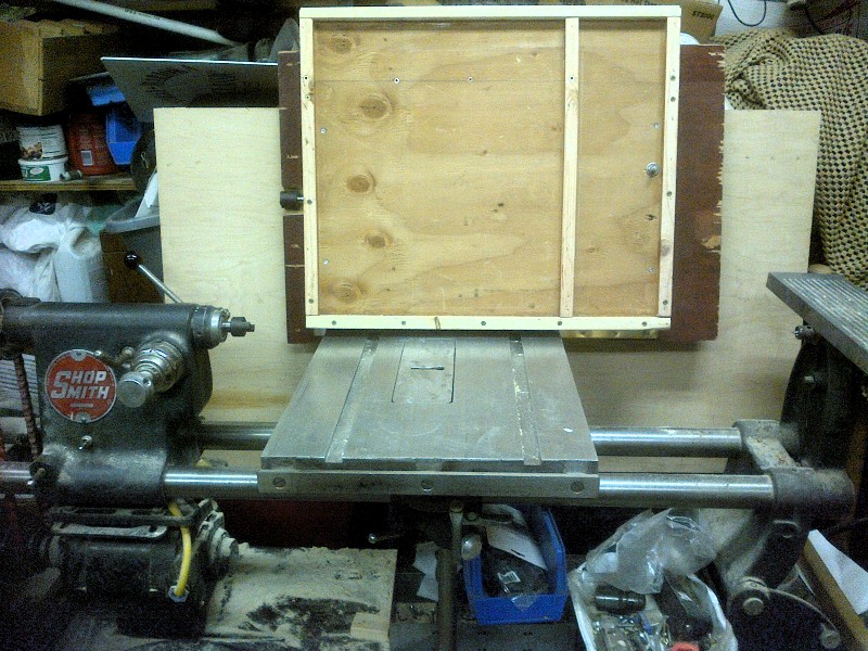

This is how I mounted an 18" V-Drum sander on my 10ER.
Mounted
[ATTACH]24673[/ATTACH]
Top open
[ATTACH]24674[/ATTACH]
and the bottom
[ATTACH]24675[/ATTACH]
At present it just sits on the table but I am getting a bit of vibration towards the right end so I will be adding some more bracing and a way to clamp it to the table.

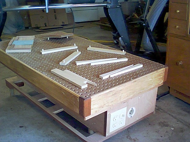

Yes, I built a fancy one, I think it is the 30" V drum, but might be 24".
It MOUNTS on, and is driven by the shopsmith. 4 short round legs fit
into the table saw mount holes and the end mount holes, which it overhangs.
Basically is a BOX, based on the Stockroom supply DRUM SANDER PLANS.
Has a large 4" vacuum connection, and a 120 Outlet. Hooks to motor
with standard shipsmith accessory connector. Top is made of 2 thicknesses of 1 inch mdf, so very stirdy. Formica (not melamine) top.
The base has cutouts (reduces weight a little) for handling.
I am still working on mounting the full length OVERHEAD roller to provide
even pressure. Once hinged lid is open, there is lots of storage inside
for folls of the special sand paper, etc. , and all the accessories for my downdraft palm sander table.
SORRY, I have no photos of the Drum sander part of it, nor any plans.
It is essentually based on the stockroom supply design sized for SS.
All lost to a disc crash. It is also currently not real accessable to
take new photos. HOWEVER, I did add a drop on downdraft sanding
table that covers the V drum and formica top. Since the box has a good
vacuum draw and the box has 120V power outlet this all works nicely
for palm sanding. I made holdowns/wedges for parts being sanded, palm
sander paper cutter, a palm sander parking pad (even if still running),etc. I have photos of those, ATTACHED, the drum sander is hidden underneath.
You can see the round mounting feet. Peg board holes were all enlarged
and beveled.

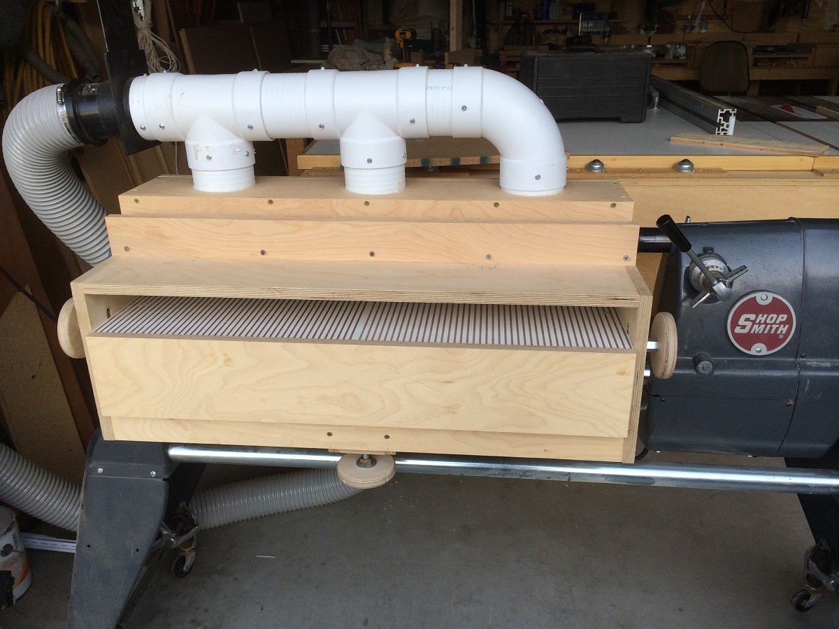

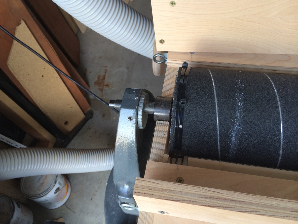

Merry Christmas all. Here is a version of a surface sander I built a while back. It works really well and will handle up to 30 inch wide by 3 inches thick stock. The drums are made from 5 inch aluminum tubing and are end capped with maple. One end uses a live center and on the other end a 3 inch faceplate. I have three drums for utilizing different grits. I have had a Grizzly surface sander and this is a far better system. It takes about two minutes to change drums/grits and is accurate to .01 inches for cabinet doors. The variable speed makes it even better.
Paul
Paul
- Sander 1.jpg (318.98 KiB) Viewed 7513 times
- Sander 2.jpg (336.01 KiB) Viewed 7513 times
- Sander3.jpg (331.24 KiB) Viewed 7513 times

Re: 24" Flatmaster adapted to Mark V
SWEET!!! Great job!
I'D love to hear more details bout how you made it and sources of parts, how the feed works etc...
Again looks great.....
masonsailor2
- Posts: 1564
- Location: Las Vegas NV
I can start a new thread later today and give you all the info. The feed is manual which is a personal preference. It would be relatively easy to build a power feed for it. The hardware is readily available stuff. The tubes are from a local metal supplier and trued up on the SHOPSMITH.
Paul
