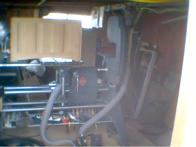

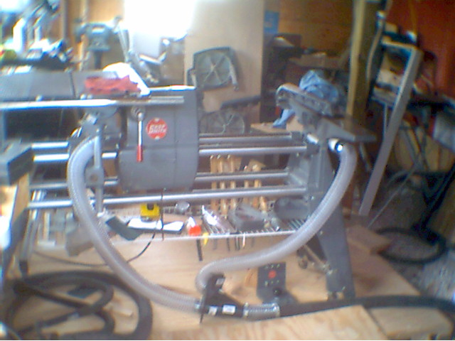

Another great thought. I just came in from the shop could not wait till the weekend. Ran some silver maple thru the bandsaw and no clogs like before. Still some saw dust inside the bandsaw. I may be being real picky I was hoping to have none in there. Pictures show my setup. The piping is 2.5 in. and only 8 feet long to DC. Threw in a coffe table/chest SHMBO wants me to hurry and finish. Thank you guys for all your help. I am going think about maybe increasing the size of the piping from the DC to the blast gates and see if maybe I am starving the DC. That will have to wait till I recoop from my spending spree at the TA. I see me order it there. Got the univeral lathe tool rest and sharpening kit.

I don't think starving is exactly the issue but I think you are close. I assume the DC has a 4" inlet, you then narrow the pipe to 2.5" which cuts the airflow by ~50%. So for so good but then you have a Y and go to two 2.5" runs the air here will be again a 50% drop plus a drop through the Y. I don't think any DC would work like this.
You want to run a 4" pipe to the Y and then get a Y that goes from 4" to two 2.5" pipes. That should fix the problem. Depending on the DC you might want to run both blast gates open to maintain the airflow in the 4" pipe.

See I knew some of you guys would know. I will try both suggestions. As you know I don't have room to do any kinda hard pipe so I used what I had. Yes my DC has a 4in inlet and I have the reducer on the end of the 4in flexable piping comming off the DC it is about 2' long. I can't wait to build a real shop at that time I will put Nicks calcualations and suggestions to work for now I have to do what I can.

kd6vpe wrote:See I knew some of you guys would know. I will try both suggestions. As you know I don't have room to do any kinda hard pipe so I used what I had. Yes my DC has a 4in inlet and I have the reducer on the end of the 4in flexible piping coming off the DC it is about 2' long. I can't wait to build a real shop at that time I will put Nicks calculations and suggestions to work for now I have to do what I can.
You don't need a permanent shop, you just need to run the 4" pipe to where you need it and put the correct splitter there.
I have 6" permanent pipe from my dust collector to my shop then I split to 4" flexible pipe to near my machines and then if I need to I have a reducer at the end to attach to the machine. With the Shopsmith I use 4" for the lathe and drill press but 2.5" any time I need to connect to one of its dust ports.
