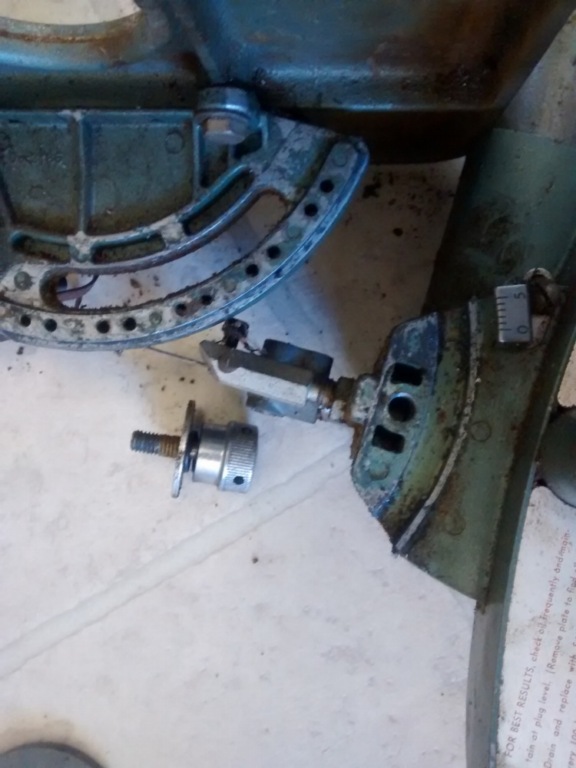

If I understand correctly, the two pieces that mate together, one with an arc shaped groove and one with a matching arced tennon (lack of better way to describe it) don't fit tightly. In mine they do. I can rock the part that the table bolts to when it is sitting by itself (not screwed down) but only a very small amount. With the part rotated/slid to one extreme I can just barely feel it rocking as I twist as if around the bolt that tightens it. At the other end of the range it moves a tad less than 1/32". I brushed the crud out after taking the photo but before checking the movement.
[ATTACH]24752[/ATTACH]
told you it was dirty! Blurry, but yeah, those are the only parts I encountered.

Yes... the mounting tubes are not the source of the movement..The movement is between the the saw table and the saw base...I wish there was a way for you to actual see the movement.JPG40504 wrote:Dumb question:)
Are you observing the trunion move relative to the base, or have you verified the mounting tubes are not 'loose'/moving?
DQ #2, what is the crud in the groove in the second pix in the second set?
What I am seeing is the play between both haves ...Male and female of the trunnion...Instead of the parts having to move in an arc as a bearing... there is so much play /excess clearance that they can rock from one edge of the grove to the other with an obvious clink..clonk at it hits both sides of the grove...It never slides along the path of the trunnion but rather is rigidly held at it's position along that path...Nothing is sliding ...only rocking on the point provided by that spring loaded washer...And limited by the width of the groove ....
The crud that I believe you are referring to is white lithium grease...
The parts are clamping tightly...In the direction that the screw is compressing them...But there is play in a direction perpendicular to that ...A movement that I feel should be limited by the tolerance between the tongue and groove of the trunnion....Leading me to believe that the parts are not actually a match?..JPG40504 wrote:IIWM, I would clean all the paint(paint remover only) from the flat surface the surface the trunion presses against when the screw is tightened and the groove and mating surface. I think the parts are not 'mating' tightly.
I may try removing the paint but I doubt that will help because ...It appears to be a situation of to much.. (Excess).. clearance rather than not enough clearance..
I am afraid that you are right and that there is no easy fix...and that if mine was right it be as you describe yours...fitzhugh wrote:Well that was easier than I figured - nothing stuck, just very grungy.

20/20 hindsight ..I now wish I had tried to check the operation of mine before I started...But there is no going back..
Just came back in from the shop...and I have solved the problem....
That trunnion bolt part # 32 with the complicated spring and washer...When I replaced it with just an ordinary bolt and washer...It locked down and stays put just like it should...
I tried installing it half a dozen different ways...With a washer under it...tightened way up with an allen wrench for a cheater...No matter how I tried ...no joy...It would always rock...
Every time that I replaced it with the regular cap screw...Problem gone...
I don't know if a new part would work but ...I'm going with the ordinary bolt and washer...or perhaps a fender washer...
Thanks to all of you that tried to help...
