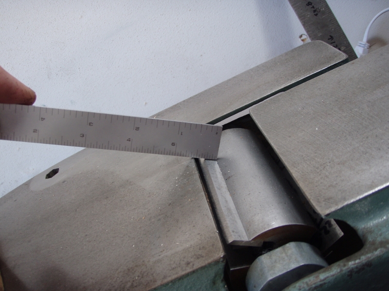

Jointer Blades and Cutter Head
A Blade in a Cutter Head.
It appears to me that your cutter head is either assembled differently than mine or that your cutter head (a greenie) is different with regard to how the blades are seated.
[ATTACH]25273[/ATTACH]
What I see may be an optical illusion (your first and second image). Is there space between your cutter blade and the body of the cutter head?
- A Blade in Cutter Head 001.JPG (89.55 KiB) Viewed 2632 times

What appears to be incorrect? It is assembled the same as the one in the functioning jointer (I think).
My wedges are different but I think that was a design change in the wedge and that they are interchangeable. I cannot confirm that.

Dusty, sorry that looks right, that is how mine is, wedge in front of the blade, head to the rear for support.

If you look at Dustys last pic, I have 9/32nds from the cutter head to the heel of the bevel on the back side of the blade, seems WAY to much unsupported blade above the cutter head.

rbursek wrote:If you look at Dustys last pic, I have 9/32nds from the cutter head to the heel of the bevel on the back side of the blade, seems WAY to much unsupported blade above the cutter head.
Do you have the infeed and outfeed tables set to be coplanar. Maybe what I am seeing (interpreting) incorrectly is with reference to the tables.
In my images the tables are set for about 3/32" cut (infeed lower than outfeed).
Good eye Dusty!
That would be a BINGO! No!!!! I also did not notice the views are from opposite ends.
See how helpful pix are!!! One who puts stuff together incorrectly is not likely to say so as clearly as a freakin pix.
FWIW my goldie version backside head periphery to bevel heel measures the same(5/16").

I dont know where the tables are at the moment to each other. The blades are set to a few .000+- of the out feed table, issue is why are they do high above the cutter head body to be almost flush at the top stroke with the out feed table. In feed table at this point is erelavent.
Rbursek look at the 3rd pic in your post #8 and Dusty's post #11. SEE the diff in the height of the adjustment screw? How WIDE are your blades?
Barely wide enough!beeg wrote:Rbursek look at the 3rd pic in your post #8 and Dusty's post #11. SEE the diff in the height of the adjustment screw? How WIDE are your blades?
11/16" is the lower limit recommended.
