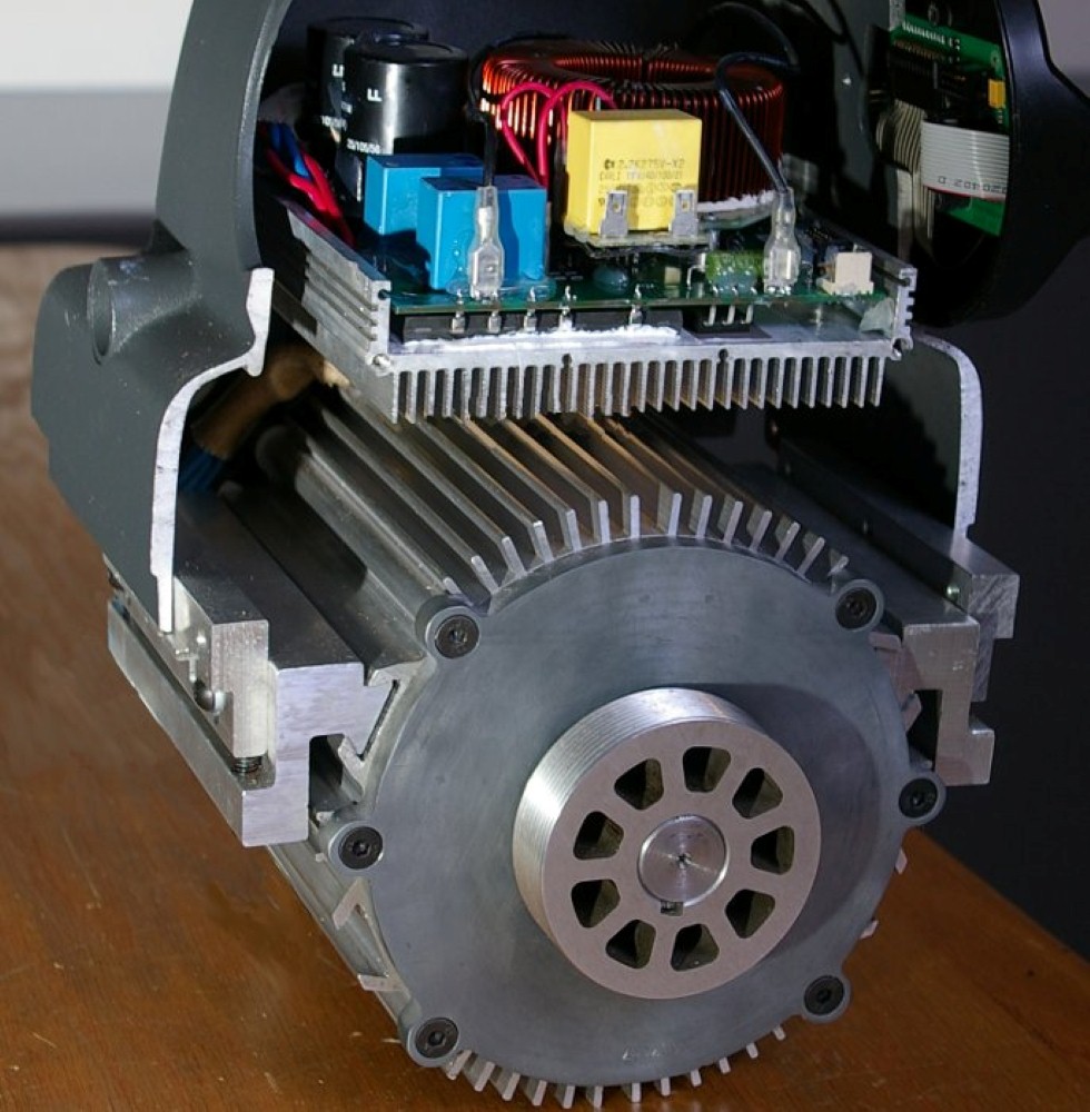

Trying to understand the difficulties in troubleshooting a No Power problem in the PowerPro.
Can anyone identify the connectors that are shown in this photo image.
I see two with no wires connected (right by the yellow block). Are these the two wires that go to the on/off switch?
I also see two connection points that have connectors attached. Are these the two wires that go to the motor?
I see a ribbon cable coming off the Control Panel. Are all connections to the control panel in the ribbon cable? Is the ribbon cable connection to the Control Panel shown in this image?
Is the white block to the right side of the image a wire terminal?
The million dollar question: Are any of these points accessible in a fully assembled PowerPro?

As I read this, I come to the conclusion that the wires to the motor and the wires to the switch are not shown in this image.beatnik wrote:Just reading this, maybe ?

The pic in post 13 is a cut-away view inside the power module. The PM is sealed. Opening it voids warranty.
