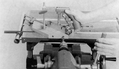

This won't give you an excuse to buy the biscuit joiner, but it should work for your miter joints.
[ATTACH]25491[/ATTACH]
Dowelled Miter.jpg (14.81 KiB) Viewed 2609 times

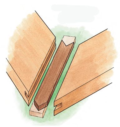

Splined Miter Joint
Post by rlkeeney »
I have found splined miters to be very strong.
[ATTACH]25556[/ATTACH]
Splined Miter Joint.jpg (23.02 KiB) Viewed 2574 times
Robert Keeney
