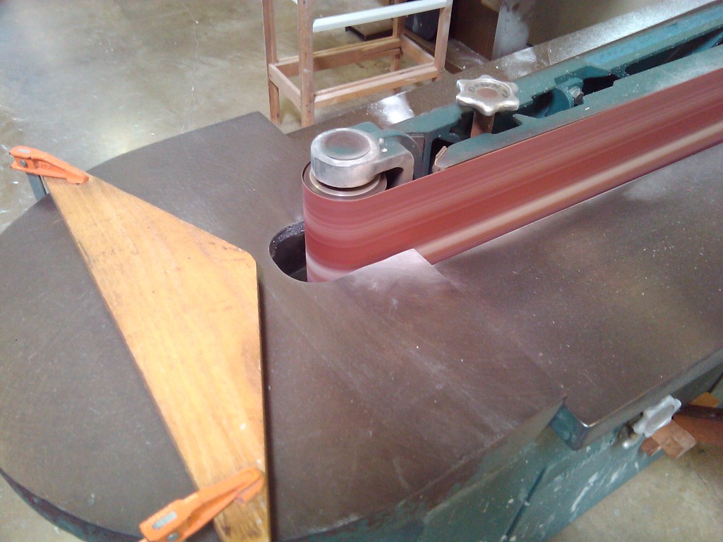

If a 'large' oval, I do not see the 'scary' part.beatnik wrote:I do this regularly with curved pieces. You don't want to get an enclosed loop in a set up like this with a drum sander though. It would be scary. I think that's whats being said ?
What sizes of ovals are ya doing?
I was referring to the earlier posts re interior sanding an oval with a drum sander using a 'pilot' and pattern.beatnik wrote:Maybe I've been around this 3 phase machinery too long, that set up shown has tossed pieces 40 ft.
That thing you pictured can indeed create scary since that is a 'pinch' setup. I assume it is intended to create a 'width'. Cock it a little and it is airborne.
