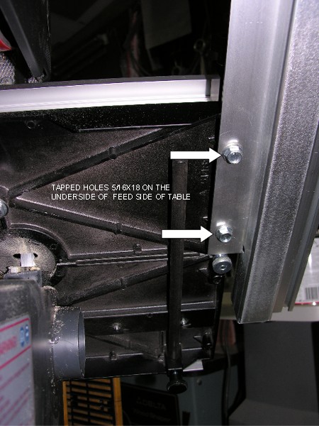

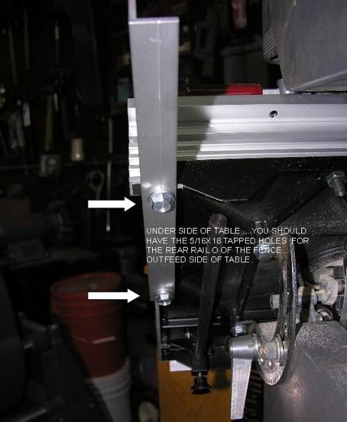

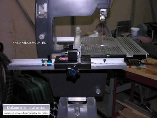

Butch,
Here are the pics. I hope they are of help to you. If the holes that I have pointed out don't have threads you may want to contact Shopsmith. You are going to really like this fence.

THANK YOU! for the great pics. I printed them off and double checked my bandsaw. I'll call SS. My table has the tapped holes on the outfeed side of the table, none on the infeed side. Not sure why, as I've stayed up with all the upgrades since I bought my SS in 1980. Hope to get out of Puget Sound in a couple of weeks and spend a few days in your neck of the woods. Hope it's WARM! !
