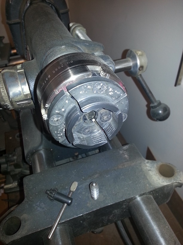

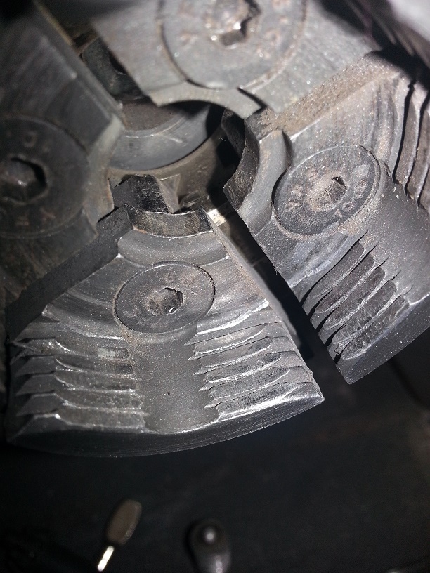

I used my ONEWAY TALON CHUCK. I messed up the jaws before I figured out to put some rubber around the tube.rbursek wrote:joedw00,
what kinda chuck is that on the ER in your pic? I would appreciate more info on it please.

Joe00,
hos does that mount to the ER? Any thing special to do to get it to mount?
- "Wild Bad Bob"
- Posts: 1065
- Location: Germantown, Wi
Same way it mounts on my 52
I dint know how that mounts either!!!LOL

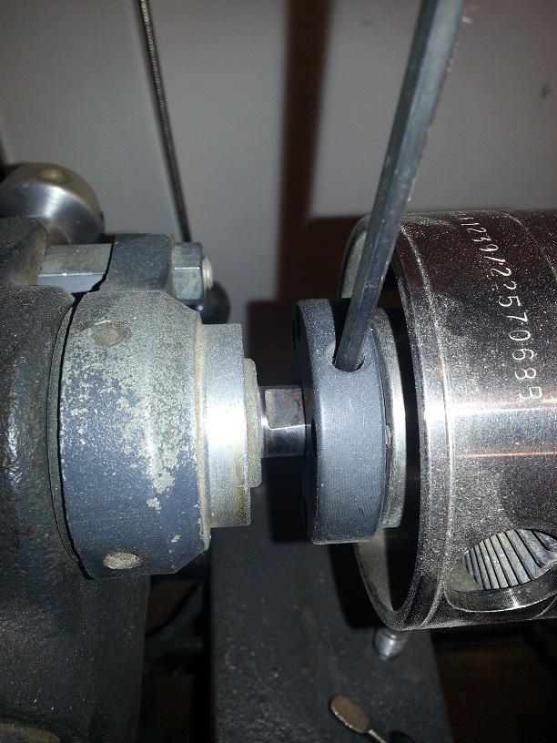

Same way you mount your saw blade or drill chuck on it, with a set screw.

I don't use any adapter. It just slides on like any other tool.Mike907 wrote:The chuck needs an adapter for whichever lathe it is to be used on. The 5/8" plain adapter fits Shopsmith.
