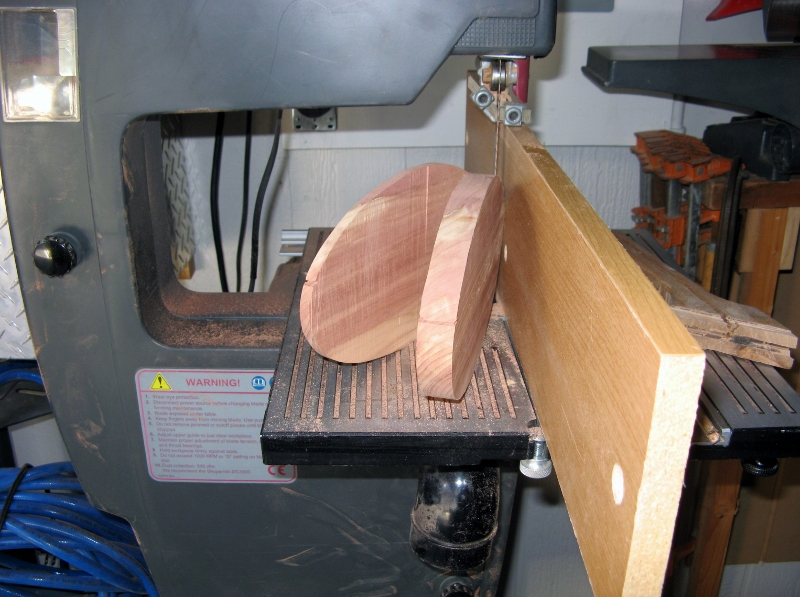

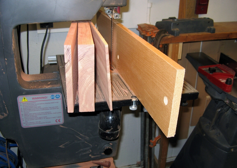

Inspired by Fredsheldon I decided to make a band saw box. I am not sure if I should thank Fred or blame him.
My band saw has the factory guide blocks and my SS brand 1/4in blade normally lives on the band saw. To make the resaw cut I installed a SS brand 1/2in blade. The first cut ( thin side) turned out just fine. The second cut (thick side) was bowed.
The second picture shows the results after truing the guide blocks. Because of the shape of he piece I cut it from both sides the nick in the thin piece is where the cuts come together. It is less than the width of the curf.

Stumpbuster wrote:I don't know if this will help but this is my recent band saw experience.
My band saw has the factory guide blocks and my SS brand 1/4in blade normally lives on the band saw. To make the resaw cut I installed a SS brand 1/2in blade. The first cut ( thin side) turned out just fine. The second cut (thick side) was bowed.Next I replaced the 1/4in blade and readjusted the guide blocks made some cuts. After the cuts were made I replaced the 1/2in blade. I was having a hard time adjusting the guide blocks. After removing the guide blocks, finding my glasses, and examining the blocks I found that I had created a wear step on the backside of the guide blocks. I think I pushed the blade past the wear steps and skewed the blade on cut 2. The next challenge was to sand the correct angles in the guide blocks. I clamped the blocks in the miter Gage and used the disk sander (not spinning) to restore the angles.

P.S. I am curious why the fence is outside the blade? I would think the workpiece would be more accessible if the fence were in the throat.

After clamping the block I used one hand to move the miter Gage back & forth the other to bring the disk to the block. I felt that spinning the sanding disk might remove stock to fast or catch the block & send it flying. I figured better safe than sorry.
Are you familiar with the term screwup? The particle board fence extension is finished on one side only. I marked and drilled the screw holes from the wrong side. So thats the reason the fence is on the outside.
