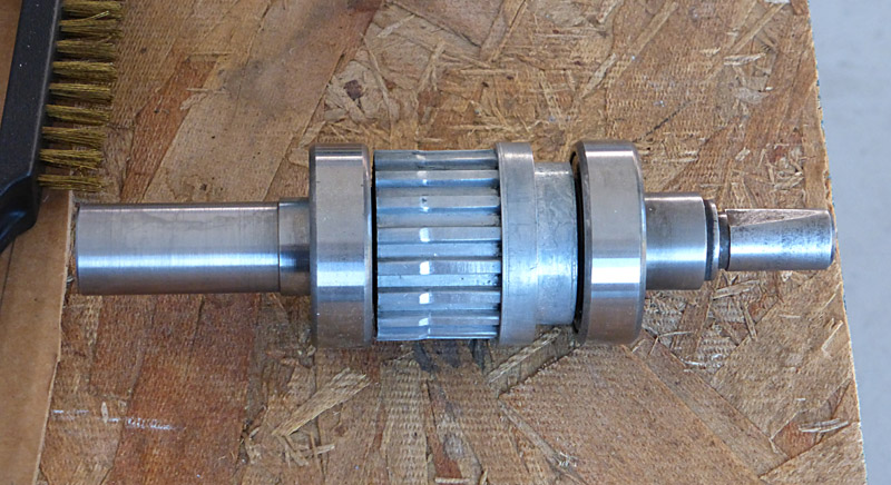

What grunge! That interior looks clean fer its age!!!
That motor is the correct age if not actually the 'original'.

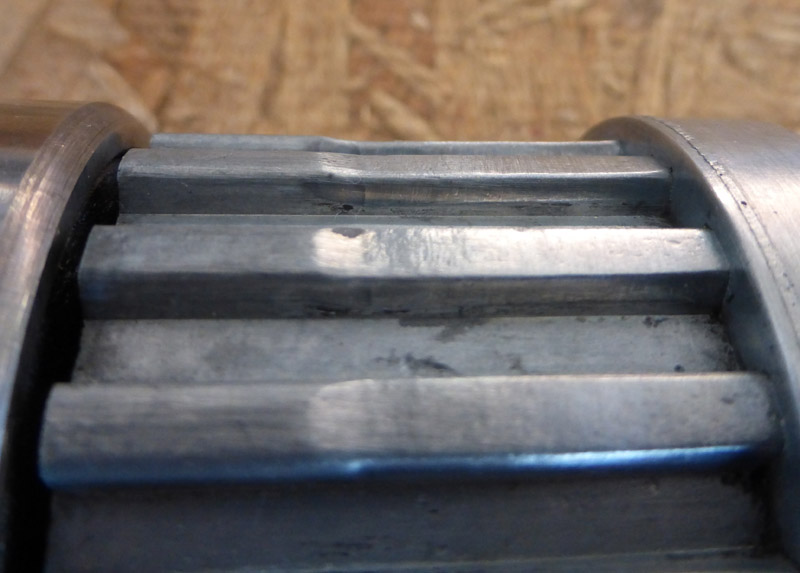

That gilmer pulley on the main shaft is in decent condition. The bearings are replaceable. The gilmer belt fraying is likely caused by the belt riding to the rear of the pulley(caused by misalignment of the idler sheave pulley).
Slop in the quill splines is to be expected, but greasing will remove the noise if not the actual backlash.
Yes replacing the entire drive train will greatly improve it, but $$$$$$$$$$$$! :eek:
Not sure, but I believe a Gilmer idler sheave might fit onto a new design idler shaft.

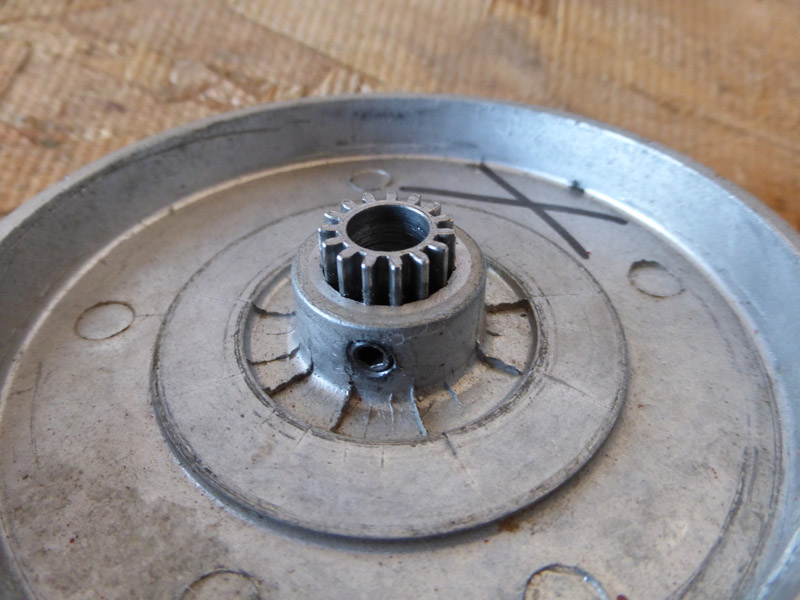

As for the speed control, two things jump out from your pix.
I agree the wear on the steel face of the porkchop is bad. More than likely the gear teeth on the other side as well. The porkchop is available from the mother ship by itself.
Second, the cause of the pork chop gear wear is the bent leg that repositioned the porkchop relative to the worm gear. That is restorable if done carefully. Bill Mayo has come up with a 'fix' that eliminates the tension pin and prevents the legs from separating.
Actual cause is forcing the speed control towards slow(the dreaded speed control damage admonished against).

JPG wrote:Second, the cause of the pork chop gear wear is the bent leg that repositioned the porkchop relative to the worm gear. That is restorable if done carefully. Bill Mayo has come up with a 'fix' that eliminates the tension pin and prevents the legs from separating.
Thanks again JPG! Hey Bill, would you be so kind as to let me know what your 'fix' is for the Speed Control and costs?

JPG wrote:That gilmer pulley on the main shaft is in decent condition. The bearings are replaceable.
Hi JPG,
The main shaft's bearings are in excellent condition! if the gilmer pully is usable, then the main shaft assembly is good to go?
What do you think?

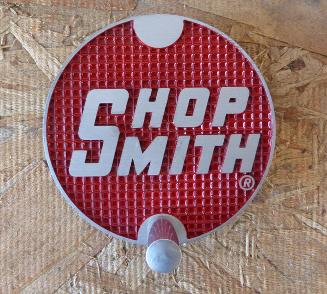

A quick update. I received my refurbished Speed Control Knob this weekend and boy does he do a great job! I can't wait to see it working on the restored headstock.
Hi JPG,
What do you think?
The Gilmer teeth wear is about average so I would reuse the pulley and replace the Gilmer belt. I find that when the Gilmer clutch set screw does not line up with the flat on the end of the drive sleeve, the set screw has become loosen. I would align the set screw with the flat and see how easy it is to slip the clutch. I try for 12 to 16 pds of torque to slip the clutch. You want to make sure the Gilmer belt is riding at least a 1/16" or more off the back edge of the clutch teeth. I sometimes have to move the idler shaft bearing within the eccentric bushing to achieve this clearance.
