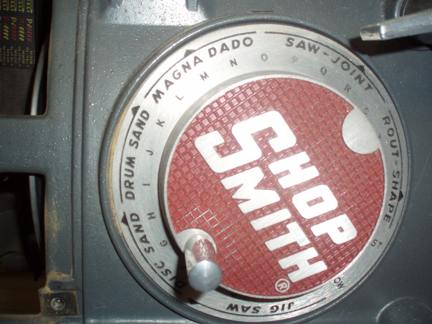

Knowing the speed control setting give an indication of how wide open or closed the sheaves should be.

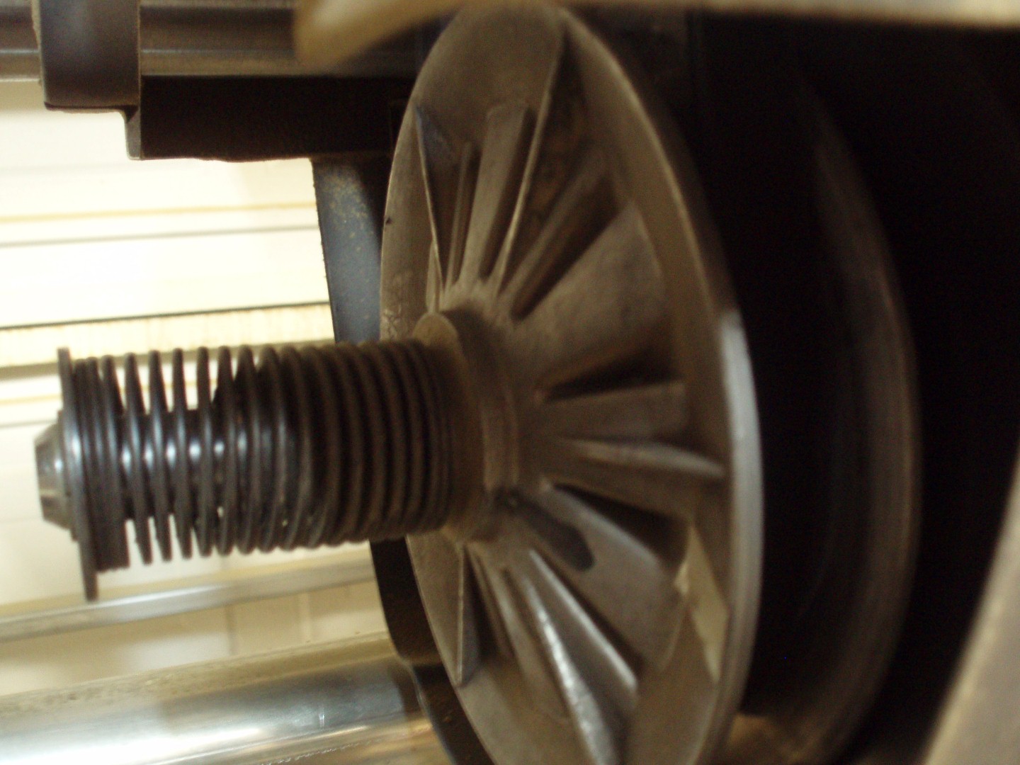

I believe the motor sheave is stuck in a position other than where it should be. The v-belt seems too loose but the spring looks about right (I gotta go look at mine).

- Speed Dial set for Saw Speed (slow)

Buckling of the spring under tension is normal. Ever tried to squeeze a spring free hand?

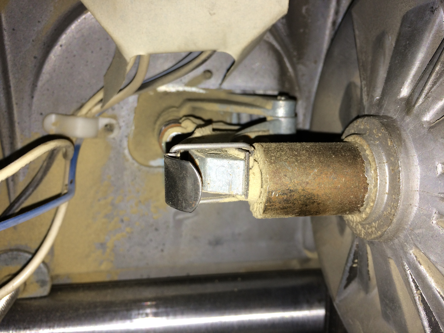

How do I unstick the floating sheave? How do I unstick the motor sheave?
Is this the inspection port you're talking about?

Yes that is the 'port'.
Surprisingly the speed control looks decent.

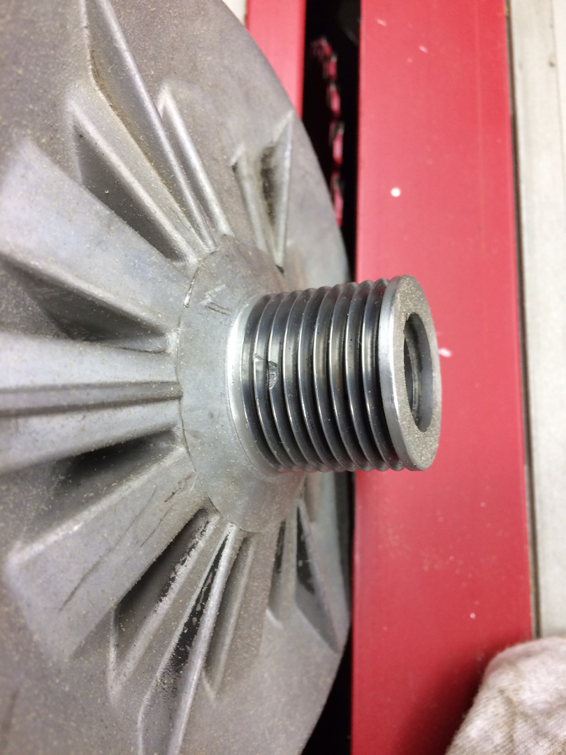

I finally had a chance to tear the headstock down and found both floating sheaves stuck. I was too aggressive on the Poly V sheave and had this happen:
Should I get a new shaft and sheave? or just file down the sharp spots on this one?

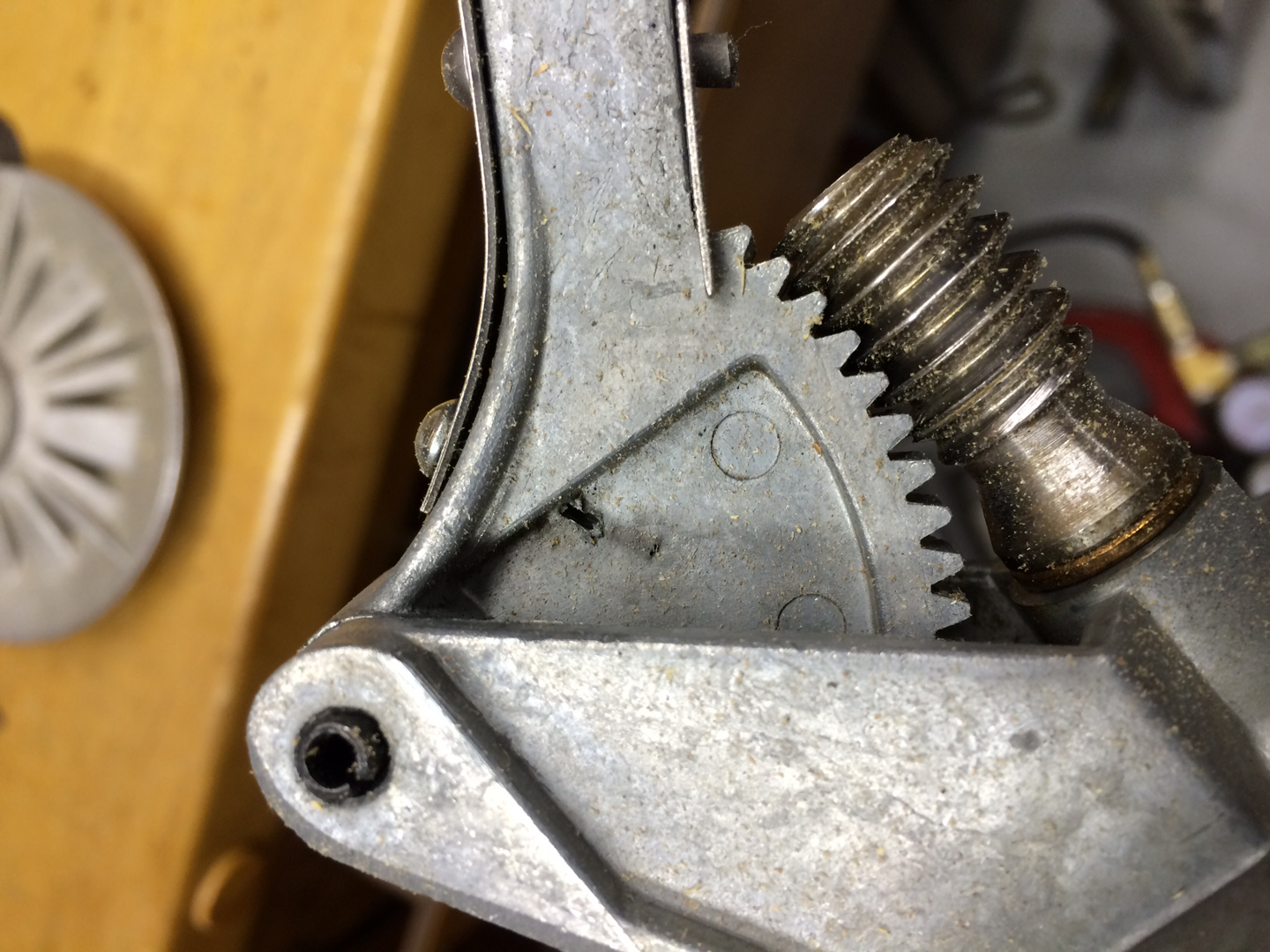

My pork chop also had an open part in it: All in all a lot of sawdust and the floating sheaves would barely move. I appreciate any help anyone can give me.

I would do that.bamend13209 wrote:I finally had a chance to tear the headstock down and found both floating sheaves stuck. I was too aggressive on the Poly V sheave and had this happen: Should I get a new shaft and sheave? or just file down the sharp spots on this one?

The void in the porkchop does not appear to be severe enough to warrant concern assuming the back side is solid.
Far more worrisome is the condition of the gear teeth on the porkchop.
Cannot tell fer sure, but the pix looks good.

The gear teeth are good. I checked them all. When I put it all together the poly V belt is lose. Is there a clock position the detent on the eccentric bushing is supposed to be? Is the retaining washer for the bushing or the bearing?

I agree with JPG that you should file the sharp edges off the poly V pully. As long as there no sharp edges coming in contact with the belt there will be no excessive wear. The hole in the pork chop casting may be a slight blow out that occurred when the rivet holding the spring in place was pressed in. I don't think that it is of any concern.
The teeth on the speed control seem to be real good for a machine that is of that age.
