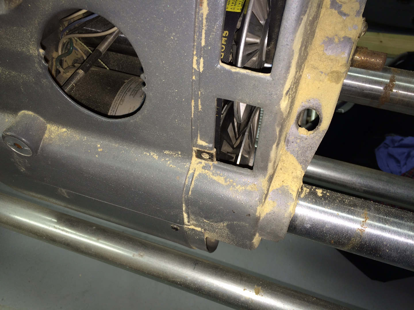

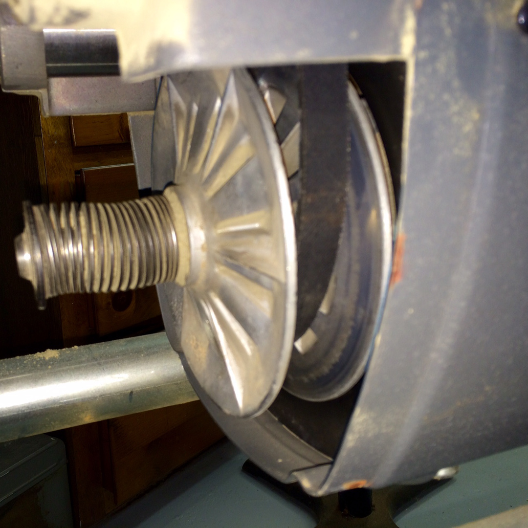

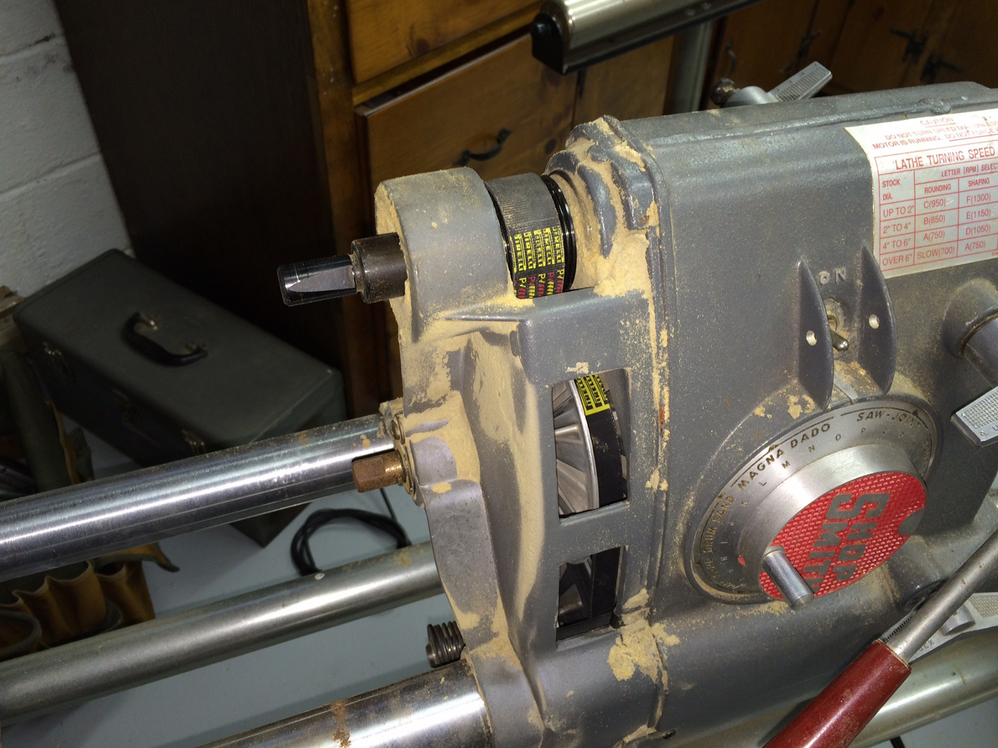

Just brought home a SS 510. It hasn't been run "in years" and is full of dust. The motor turns but the shaft won't. It turned at first and when I ran the speed control all the way down and back up it stopped turning. The belts look new. I looked at the bottom variable pulley and it's wide open. There's a gap between the spring end and the pulley. The whole speed switch is caked with dust on the back and hasn't been oiled in a while. I ordered the Mk V Help Kit & Train DVD but it's backordered. Would this show me how to clean it up and lube everything up right? What else can I do to clean it up and get it working? Any other tutorials out there? I appreciate the help.

It looks to me that the motor "floating" sheave is in the low speed setting and the Upper sheave (The control sheave) is also in the slow position.
First You should turn the shafts by hand to see if they turn at all. If they do, then feel the belts to determine if they are tight. The tension on the V belt is determined by the spring on the bottom sheave. If either of the sheaves do not move far enough to maintain the tension on the V belt the shafts will stop turning due to belt slippage.
If this checks OK then install the sanding disc and while turning the disc by hand adjust the speed control so that the spring is fully expanded and oil the sheaves through the oil holes on the shafts.
MAKE SURE THE MACHINE IS UNPLUGGED WHEN YOU DO ANY MAINTENANCE. Full line voltage is on the rear of the switch when the machine plugged in.
After you do this check back here for more info.
Bill V

Re: Just purchased used SS 510 motor turns but not shaft
I wish we knew what the speed dial setting was when these pictures were taken.
The motor sheave appears to be somewhere mid-range. At high speed, the spring coils are wide open and the sheaves are close together on the v-belt. The upper sheave is wide open making the oil port accessible.
At low speed, the spring coils are tight together and the lower sheave opens thus releasing tension on the v-belt. The upper sheave should be closed tight on the v-belt.
In your third picture it appears as though both sets of sheaves are open somewhat and that the v-belt is free to move. This should not happen and I believe is the root of your problem.
With these conditions, the speed dial should be at 'mid-range'. What speed setting do you have on the dial?
I don't believe the dust is causing your problem but it does indicate the the previous owner was a bit lax on maintenance. The machine should never look like this. The dust is very fine. I would expect this if cutting a lot of MDF without ever cleaning the machine. When I do MDF, I open up the headstock and blow it out just to prevent this condition.
If you still can, would you post a picture of the speed control taken through the inspection port.
Good luck this. I believe you will be making your own saw dust very soon. A little cleaning with some lubrication and you'll be back in business.

Speed Control Setting
Here's the speed setting as requested.
Bottom sheave and spring
Also is this spring supposed to be cocked like this?

I believe that Dusty asked for a picture taken by looking through the inspection port on the rear of the headstock. This would reveal the condition of the teeth on the speed control mechanism. As well as other potential problems
The spring looks normal to me. The cocked look is caused by the spring trying to move sideways when under compression.
Bill V
