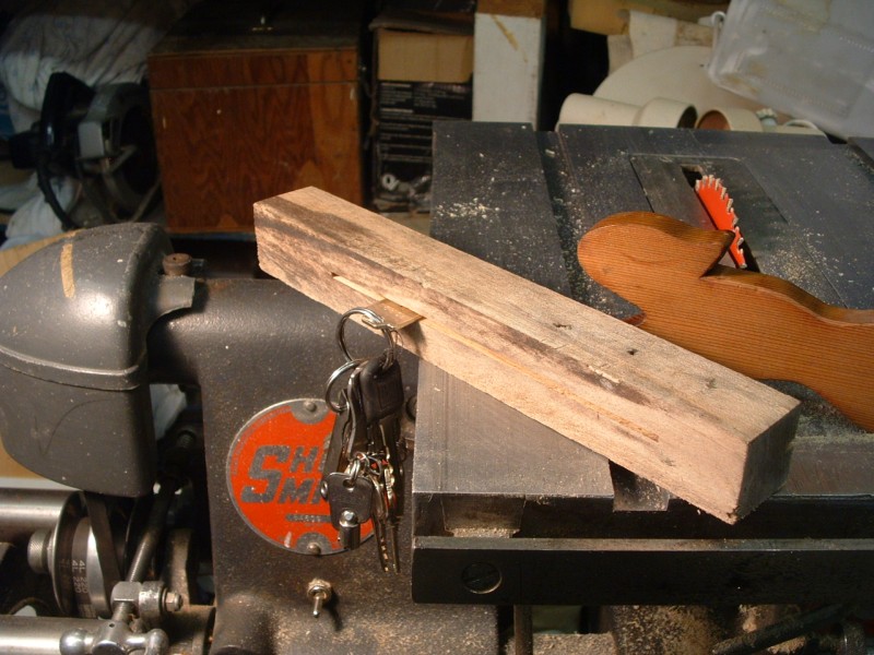

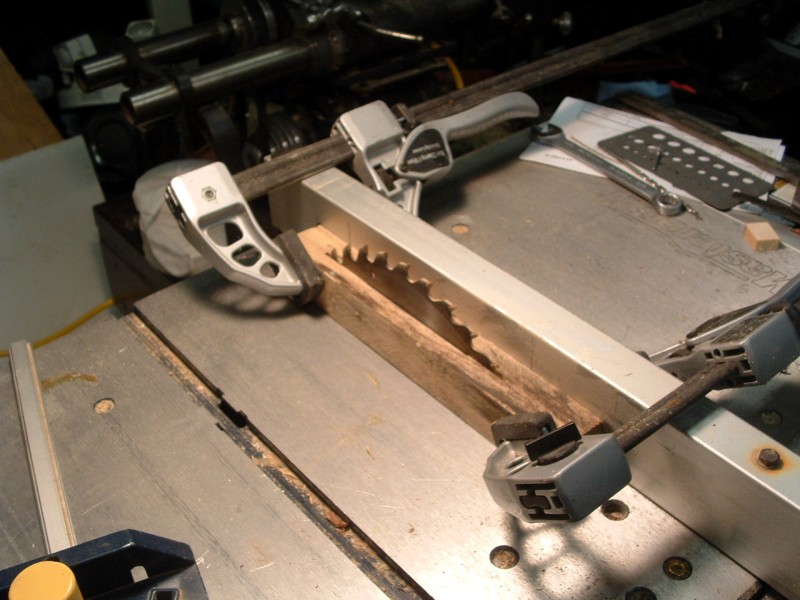

Sooo, to provide proof of concept I spent about fifteen minutes in the shop with some scrap wood.
The wood is about 1 1/2" square, the slot produce is about 7 1/8" at the front and about 9" at the back and the keys fit in the slot.
I think we have a winner.

That 10ER is my main machine and was a convenient place rest the holder so the keys could hang down.JPG wrote:Why is a 10E? in the last pix?![]()
I am used to the tree rat!
Also it provided ShopSmith content
I did try to cut the slot on the 10ER first, but with the 8" blade I didn't get enough blade exposure so I used my cheap table saw instead.
My other 10ER is set up as a dedicated drill press, and my Mk5 got stalled in restoration and is still awaiting reassembly
