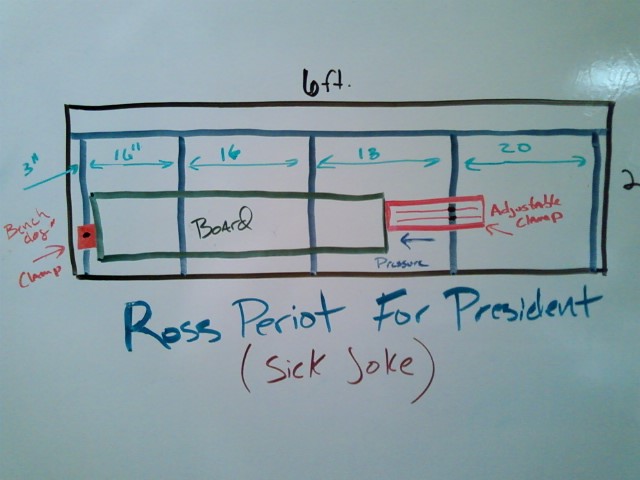

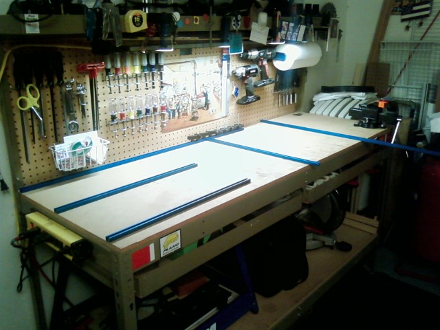

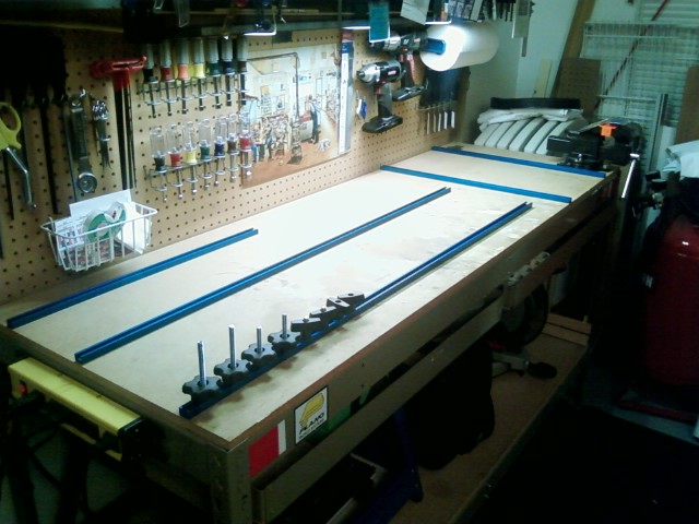

I'm Going Interactive!!!!!!!
I have my favorite one of the 3 but for kicks, whats yours. (and/or what would you change to make the top better)

Number 3
By a long shot.
A woodworkers vice on the end would allow long clamping without any shims, etc. A woodworkers vice on the side would give three stop distances that way. For that matter, just two channels would probably work as well. Remember that most benches have only two rows of holes running the length. I'd just go the whole length, and not bother with the two cross pieces at the end
Even without the vices, the three (or 2) parallel channels and some hold down clamps will have an amazing amount of flexability. The other two setups seem to have the channels a little far apart if you start working on small pieces.
If you remember to poly the groves before putting in the channel, AND drop some poly in the screw holes, it should be fairly spill proof. And some poly on the bottom for insurance.
And DANG YOU!! Now I'm thinking that routing a couple of channels in my present workbench might be a good idea.
