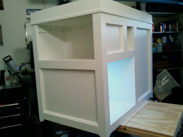

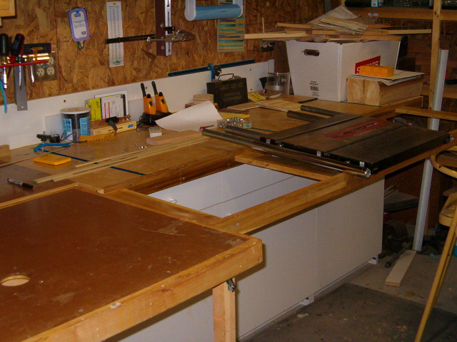

The picture is of my last project thats sitting on my make shift assembly table. My workbench is off to the left which is the back wall of my garage.
I might get screamed at......but here's a question. I'm VERY limited in the space that my garage has. I've got a one car garage that is basically dedicated to myself. (i'm somehow hiding my wife's christmas crap in totes and other various "once a year stuff" on shelves but all are organized in the best places possible) I've got a work bench, a Project center (my tool box), my MK 520, a good sized corner of peg board with various tools, a portable table saw and 2 portable clamping tables (workmates). My "assembly" table if you will is basically a Stanley portable clamping table with a 2x4 ft clamp in table top that I made with scrap plywood and 2x4's. Dont get me wrong, it worked well during my last project which was a very heavy changing table for my son BUT i'm looking to upgrade. NOW, with all my stuff basically being portable and having limited room in my garage, has anyone ever thought of using a Rousseau WorkBench System as a work bench. I'm thinking about taking one, making a custom top with bench dog holes and 2 diffrent types of woodworking vises. (vises being very important focus on this table) I bought my regualr workbench at a big box store and its basically made like the Rousseau system with the exception that the back has peg board and an upper shelf. (its a 6' "gorilla" brand) I'm thinking somewhere along the line of 32"X48" and possibly placing locking casters or some means of keeping it portable incase I need to move it. I dont use my garage for parking my veichle but I do have to keep my lawn mower and portable outdoor fire place in there. My router table and miter saw are tucked in under my regular bench keeping floor space a premium. For the most part, i'm very well organized but I feel that I need a bigger table and so far, i've not seen any benches I could either afford or have the experience in building. I have looked breifly at the "New Fangled Workbench" but have yet been able to see a real plan for it; thinking that it might be the one I'd like because of its clamping abilities. I'm going to try to send a picture of hopefully my bench and makeshift assembly table so I can get some helpful input once I figure out how to send pictures. Thanks,
Crouse!!!

That looks like a great changing table. Can you tell me what the lighted area and the bare-wood hole are for? As for the work bench, I am not familiar with the Rousseau WorkBench System, but I just went and looked at a video about it. It is probably as good as any. The thing about workbenches is that there are sooo many choices. It really depends on what you are going to do. I like to have more then one. I have one that is designed to have two different vises on it. I have one that is just a flat surface. Both of these are about 34" off the floor. I also like to have one that is only about 12" off the floor. It comes in handy for those large things (like your changing table). Of course, at 5'4", I am not the tallest person in the world, so a taller person may not have the need for a low workbench.

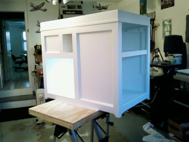

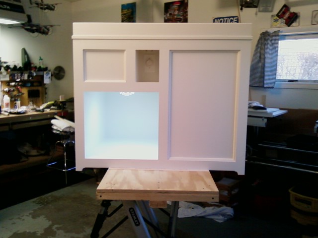

Tim, That lighted area was by the plan supposed to be a set of 3 drawers. The area goes from front to back (all the way back). I originally made a door for the front which was made with stained glass sandwitched in with plexi-glass. I placed an LED in the large cubby hole for a night light, thinking that it would shine through the stained glass for a calming effect. I spent a lot of time on that door but didn't have the heart to drill holes for the euro style hinges for it. I actually found a good basket that fits perfectally in there which acts like one big drawer. The small cubby hole originally was to hold baby power and small things for convience however I placed a light switch inside it which worked out perfectly. Tim, I think the bare wood holes (above the light control) your refering to are 2 pocket hole's that I saw no easy way to plug but they are painted. (This was my first heavy project) The whole cabinet is 26"d x 40.5" w x 35"h, which offered alot of extra stuff to be placed on top aside from just the changing pad. I received the plan from lowes's woodworking mag which suggested that it could hold one of the larger sized mini refridgerators on one side and a microwave on the other. Mine is wired for both, just incase I descide to make it a snack/game room table. (BEER!!!) I'm placing 3 more pictures for a better look see.

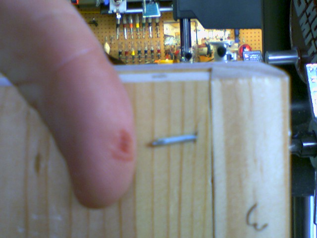

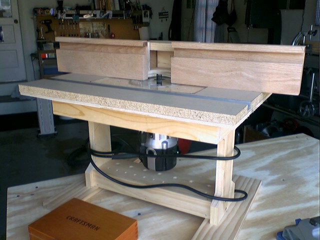

I'm still planning on making that work bench however since I'm in the business of workbenches right now I think I'm going to make an upgrade on my existing one. I know that in my last post I was really pushing the reilability of my 3/4" MDF top but I think i'm going to do some editing on it. (really more of a deletion actually) The top is 6' by 2' with a 4" bench vise mounted to the right corner. I think i'm going to completely replace that top with 3/4" baltic birch BUT i'm going to rout out sections for adding T-track. I'm going to have a 6' section about 5" from the back wall and then 3 or 4 channels of 16-18" track running up to the 6' track. I got the idea because a while back I was pulling free plans off the internet and ran into this one: http://www.bobsplans.com/FreePlans/DNLD/Workbench.pdf Now, I'm not too sure if I could pull off the t-track on the sides like Bob's theory due inpart that my bench is made of angled steel but I believe making my top more accessable to home made style clamps and jig peices from Rockler or Wood craft would be to my benefit. Here in Muncie, we have a outlet store that is ran by habitat for humanity where I could get steaply discounted cabinets to atleast save me some time and money to make Bob's workbench (which I do think is pretty cool) and have actually though about removing my current workbench with "Bob's Bench". (having a small area could make that useful, I could place my ShopSmith on that wall and move my work bench to the other........but thats just thinking um.....outloud??) ANYHOW, I'm planning on making clamps for my T-track out of UHMW stock and cutting it down into jigs like in Bob's plan. I dont know if I'm going to place my Bench vise back on the bench or if i'm going to add it to a base where I could slide it into the t-track for a "modular design". I also thought about making two 6' tracks down the legnth of my workbench and making sort of a grid system. Has anyone ever used T-track like this or have any suggestions??????
To Bob's credit, I did make his router table which I did use until I bought my Kreg Table. (the making of said table resulted in slight injury....ie...see pictures)
