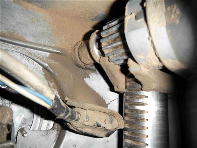

Ordered a almost new Quill Feed and spring assembly from online, the spring on mine seems weak and does not operate real smooth even after cleaning the Quill
Should point out, the picture uploaded after the order was place and it will show the reason...need to clean the Quill feed...oh well.
DSCF2712 (Small).JPG (51.58 KiB) Viewed 856 times

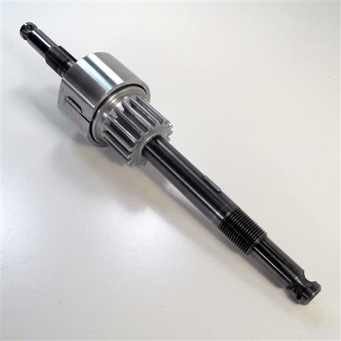

The newer Quill feed...
quill feed (Small).JPG (17.96 KiB) Viewed 856 times
